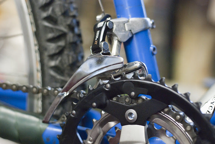

So the edge of the derailleur should be right above the largest ring when setting the height?
I'm also noticing binding when I shift to the extremes. In granny low, the chain hits the rear derailleur. So I guess there is too much slack on the chain? The old low ring was 28T. The new one is 22T. Also, I'm wondering if I should shim the BB over to the non-drive side. Seems to be over a bit more then it used to which is also causing binding.

You'll hafta pull the cage out a hair to get lined up straight, as well as to set the height. AFA the binding, that's taken care of by the limit screws. I'd bet Park Tools' website has a good demo...

I think I have it set up OK but it still clatters a bit. The problem I see is the derailleur gears are pitched inwards a bit because it's following the chain stay. The crank is a bit more outboard and so the bottom gear on the derailleur is getting caught on the links in the chain occasionally. Any way to correct this? Shim the crank in? Would this be corrected if I switched to a 9-speed derailleur?
http://lh6.ggpht.com/_NUT3v0pNW04/TO...0/DSC_0061.jpg
http://lh3.ggpht.com/_NUT3v0pNW04/TO...0/DSC_0054.jpg
I also lowered the front derailleur. It's probably more then 3mm but less then 6mm. I can't lower it any further since it hits the chain stay. Shifts nicer though.
http://lh5.ggpht.com/_NUT3v0pNW04/TO...0/DSC_0057.jpg
In your first pic you may have chainline (chainrings moved outboard) issues or the derailleur hanger may be twisted. More likely chainline.
In the second pic it appears that your chain is too long now that you have the compact crank. The chain should be one inch longer than the length necessary to wrap the big ring and large cog, not running through the rear derailleur.

I think it's a long derailleur. I did play around with the chain and I think there might be 3-4 links too long. Actually I just noticed, in the pic below the bike is in granny so there is a lot more slack with the new crank. I'll have take the derailleur off and double check.
If the crank is on correct, then how do they get the proper chain line?
http://lh5.ggpht.com/_NUT3v0pNW04/TJ...0/DSC_0018.jpg
slackmeyer 11-17-2010 08:05 PM
Melville's right on the chain thing- big ring + big cog + 1 link (or inch, same thing). To see if your crank is set right, measure the distance from the centerline of your seat tube to the centerline of the middle ring on the crank. Should be 45mm, if I remember correctly. Without being close to that number, you're not going to have good shifting through all gears.
