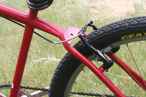

btw. any opinions on my creative rear v-brake line routing?
http://lh4.ggpht.com/_JS1yca5KB-0/S-...0/IMG_5783.JPG
click for bigger
thats a longer-than-normal noodle, its like 120 degrees of arc instead of the usual 90 degree. when I first ran the cable on the left of the seat tube with the 90 degree noodle, it just seemed like it stuck out too far unless I secured the cable to the top tube fairly close to the seat tube, whereupon the cable made the brakes lean to the side too much. this routing seems to work well enough..
also, I think I'm going to swap the front wheel to match the back (mid/late 90s narrower Shimano rim instead of the current early 80s wide Saturae rim), this way the front brakes won't be 'out' so much (I've already swapped the brake washers around, it wasn't enough).

I've seen worse. If it works, run with it.
