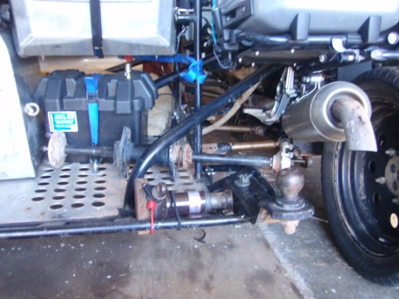

This is a few pics of a rear shaft from a quad i had sitting around, just to give you some idea of what i am trying to do.
Chain drive
Shaft drive

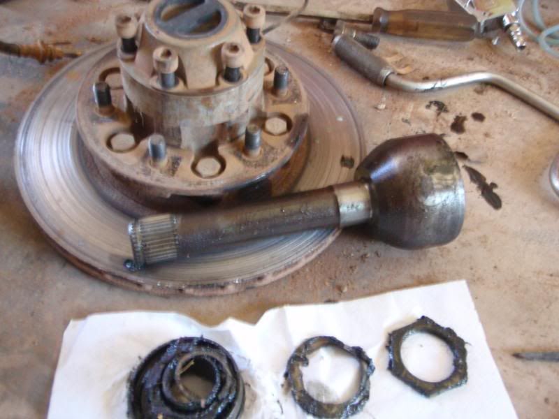

This is a toyota free wheeling hub set up. the top half un bolts to take the disc off . Will be easy to bolt our hub adaptor to it, for the sidecar wheel.
I am having a look at a suzuki free wheeling hub tonight .
Half the size of the toyota one.

Old swing arm
Hub adaptor for the sidcar wheel . This will need to be changed to suit.
We still have two blank hub adaptors to play with.
