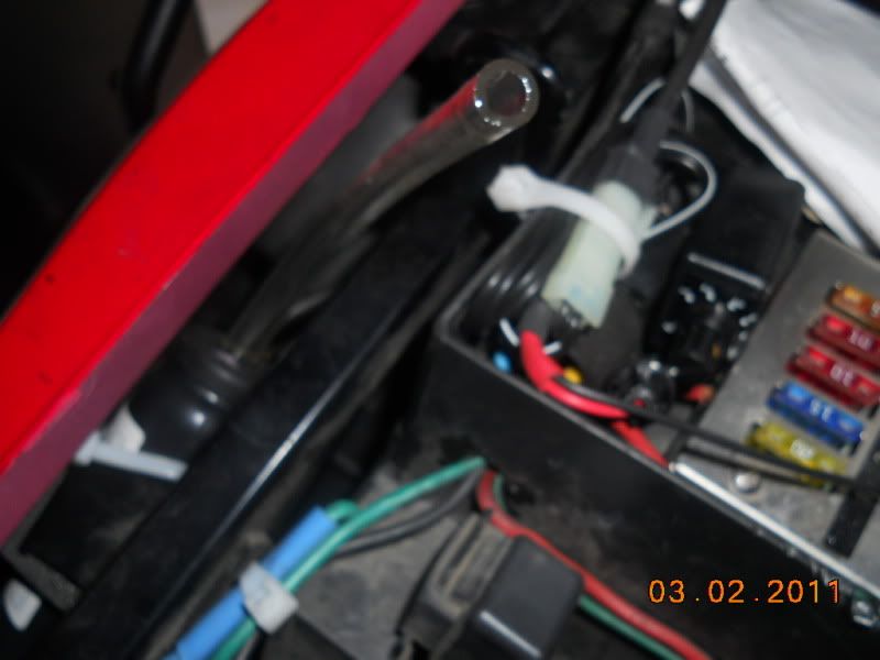

Controller - adjust to meter out oil between 30sec (#9), 130sec (#1) intervals
I didn't see any need to mount the controller near the handle bars. Once you determine what oil amount you want, it's basically set it and forget it. So, I decided to bundle it near my fuse accy box -- wired to a ignition switch controlled circuit per the instructions
