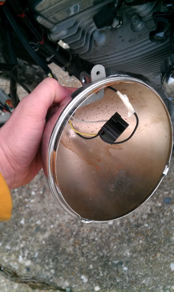

Here's that three prong plug in its natural habitat on the Sportster. It's got two grounds, one that runs back and connects through the harness to the other lights up front, and one that grounds to the light housing (shown here marked with masking tape).

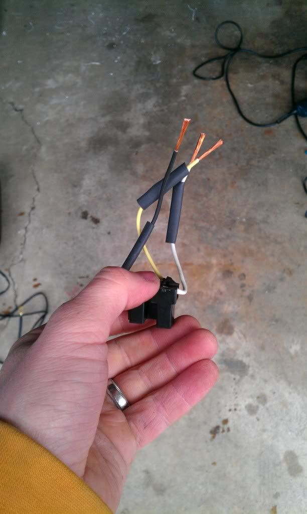

Three prong plug separated from the OEM arrangement.

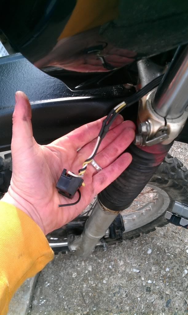

...and here it is reconnected, without the headlight housing. The wire that grounded the harness to the housing I spliced into the ground on the Britannia harness and ran back to the frame underneath of the seat.

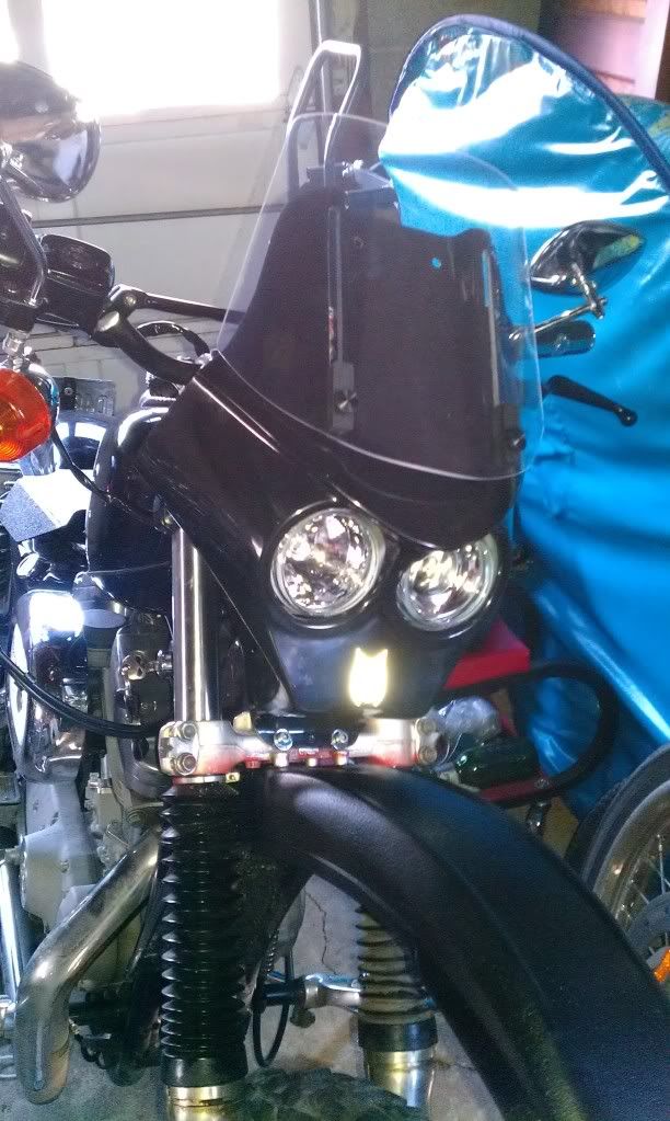

As it appears from the front, the fairing is looking pretty slick!

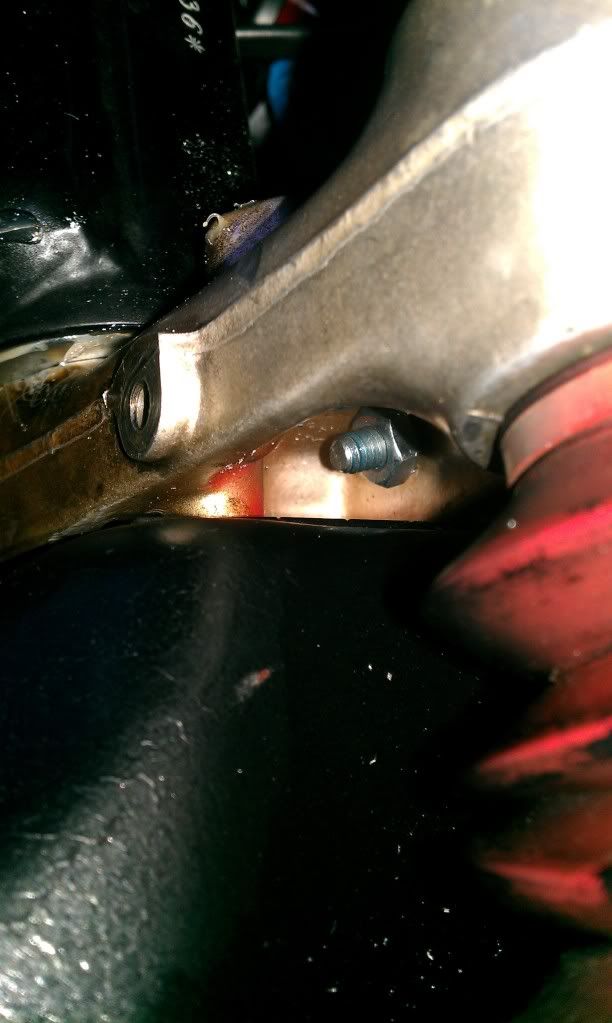

I drilled out the bottom triple clamp and tapped to 1/4"x20.

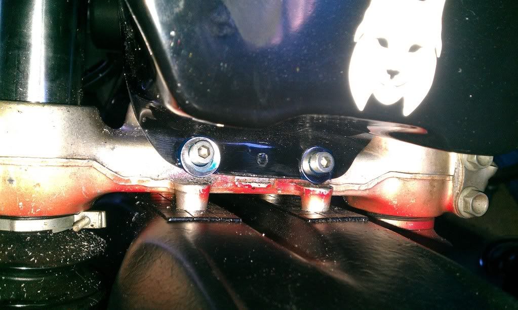

...and here between the triple clamp and the fender you can see I have also implemented lockwashers and nuts, just to be sure this sucker doesn't rattle off, as have so many other highway decorations from this bike.
