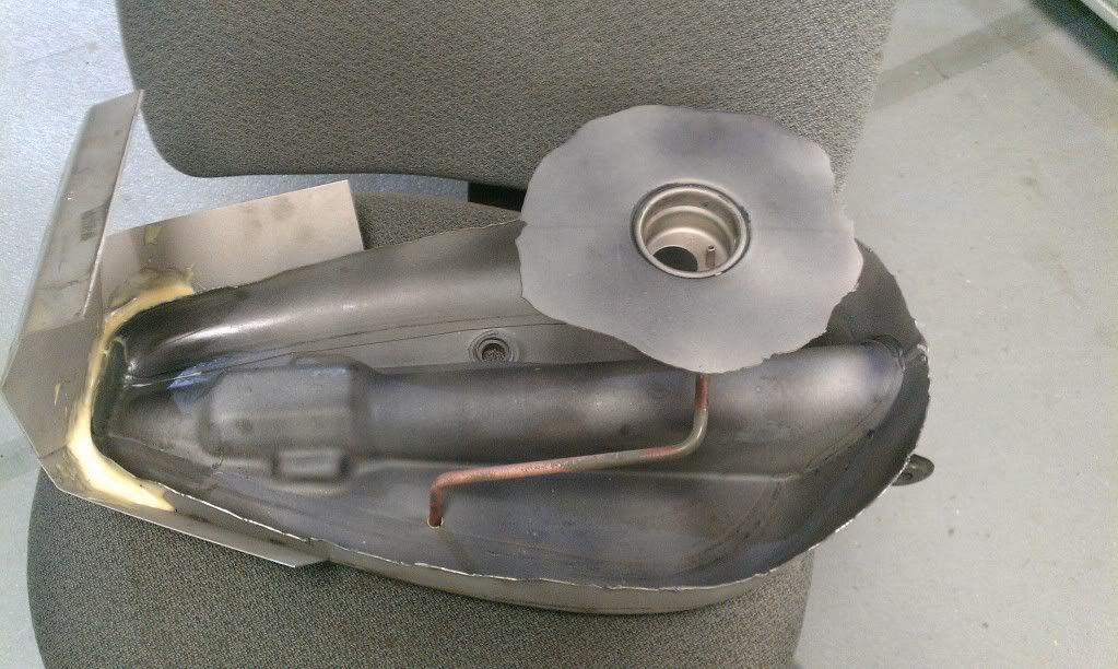

I have decided, with no consideration whatsoever for the challenge it will be, to fab up the tank with fiberglass. I will build a fiberglass tank that fits inside the envelope of the existing half tank so I cab keep mounting hardware and fittings, and I will use Caswell coating to ensure that the tank isn't eaten from the inside out.
So I sand blasted the rusty guts outta the ol' junker,
Resin and clothed the base together, leaving so fringe around the edges to help mate the sides to the base later,
