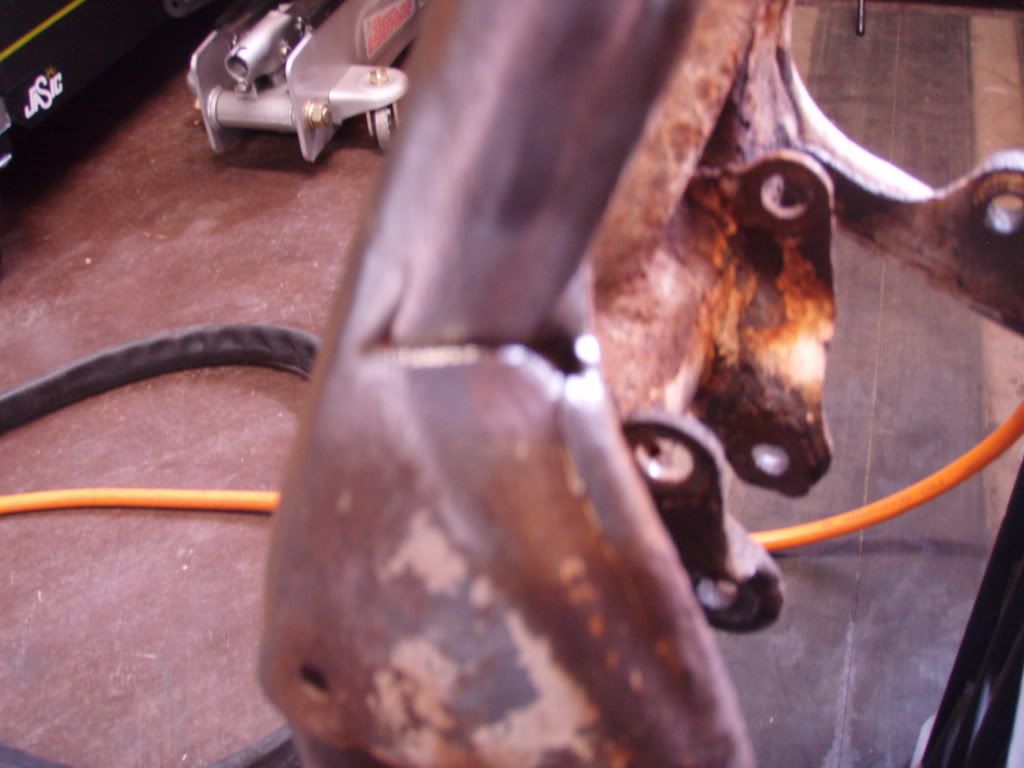

As for the frame it's stripped and i've been doing some welding, repairs and cutting off bits and pieces that won't be used. I found a fairly large crack where the sidestand was mounted to the frame and repaired it.
[IMG]
I'll plate this later as well when I fabricate a new stand mount to stop it happening again. I want to fit a KTM style sidestand that folds right up and sits near the subframe out of the way.
