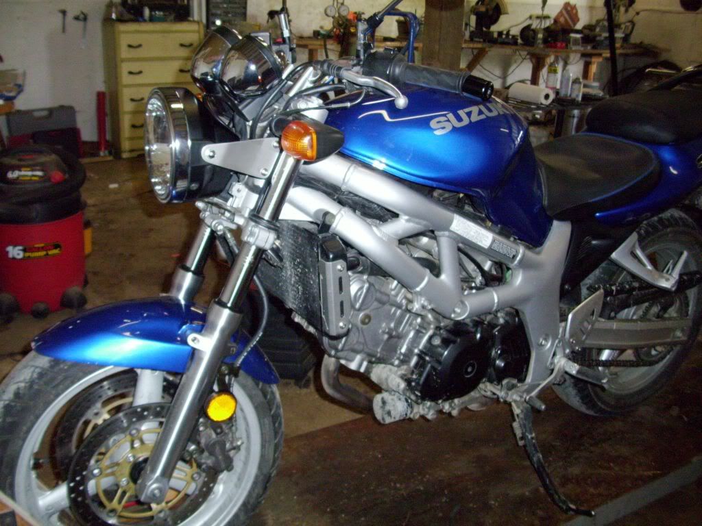

This is my baby (well, the mechanical one). It is a 2001 Suzuki SV650 in the exact same color as the '02 I rode once upon a time and hated to have to sell. I paid a bit more for it than I would have liked, but still a decent deal.
[IMG]Photobucket[/IMG]
The person I bought it from liked wheelies, so both fork seals were bad, and the leaking oil contaminated the brake pads. So, I spent a week ordering parts and spending the rest of my budget on things I could easily bolt on or modify to make it more dirt worthy. In the mean time, I LET my husband play with some fabricating with me (it is his shop and you try keeping a mechanic away from a modification project). So here are the first round of mods with his "help".

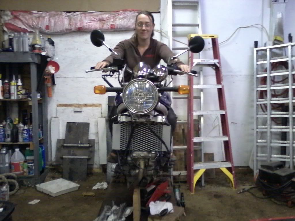

Here's my short self testing them out. By the way, when posing for a side shot picture, take all tools, keys, bolts, and other things out of your pockets. It makes you look like you have a beer belly.
[IMG][/IMG]
[IMG][/IMG]
That last picture had a radiator guard. Super cheap way of doing it is to get some thin gauge angle iron and expanded metal, cut, weld, and paint.
[IMG][/IMG]
[IMG][/IMG]
