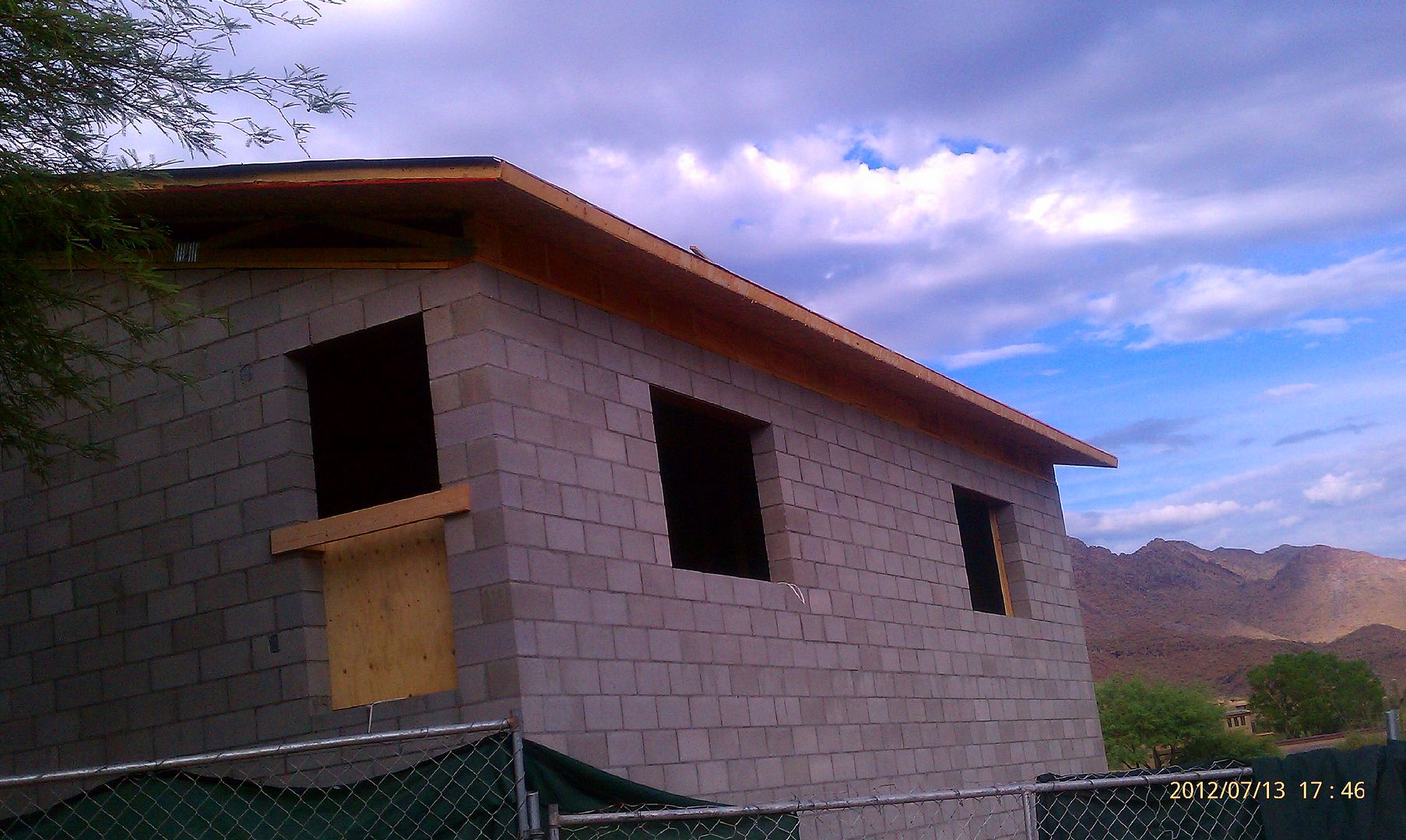

The manufacturer's rep came out and measured the crack. It only measure a half inch deep and that was acceptable tolerance according to the manufacturer. We made them certified the glulam copies are recorded with the arch. and copy to myself.
The good thing about this glu lam it was over engineer and not holding a lot of load.

THE ROOF GRIDS AND FLASHING ARE ALMOST FINISHED. TILES WILL GO ON NEXT WEEK.
