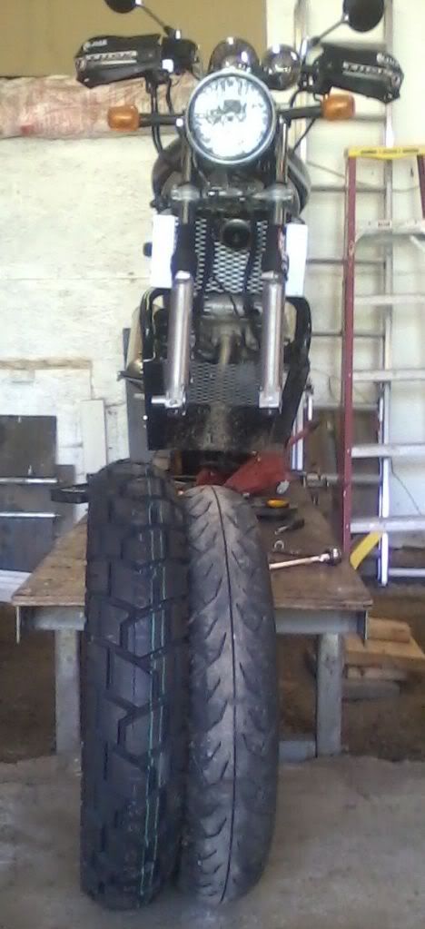

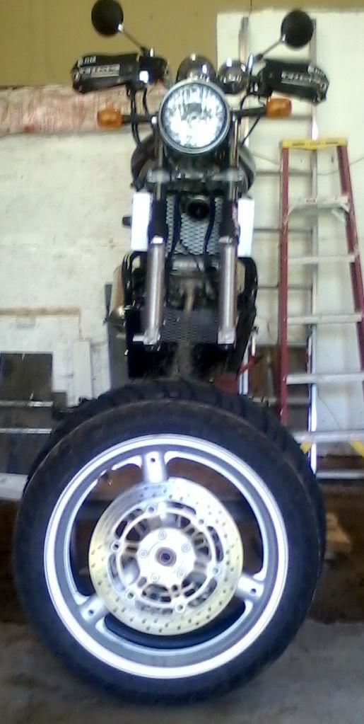

So, time to replace that front tire. Only problem was the fact that I am still running the stock wheels and finding dual sport tires in 17" leaves you with few choices. So, I decided on the Shinko 705 because it is practically the exact same tread pattern as the Full Bore. And, the height of the tire made it the equivalent of a 19" tire instead of a low profile 17". PROBLEM! When it arrived in the mail I realized that not only was it a rear tire (so I would have to mount it backward inducing a wobble at high speed) but it only comes in a tubbed model in that size. But I am one tenacious stubborn woman, so we made it work. Here are a couple comparison shots.
New one behind the old one.
Side by side.
