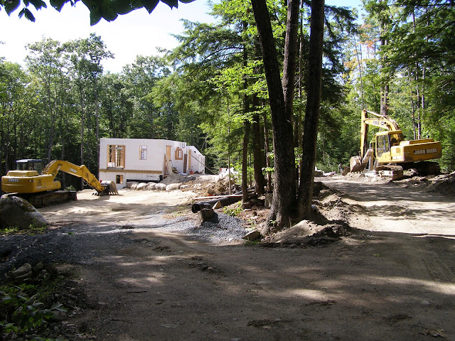

So we've got one more floor system to assemble, run the heat tubing, build some knee walls for the top story and we'll be ready to hand this over to the GC to put a roof on it and finish it up. I can't wait! I've had enough of this and we're nowhere near done! Probably just too much going on right now. And my wife is a Saint for putting up with me.
And who needs two excavators anyways?
From September 2, 2012
