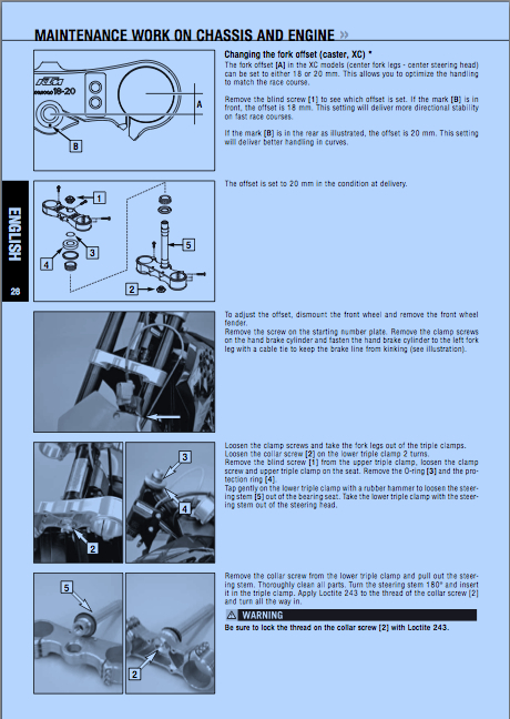

Originally Posted by DirtJack View Post

thanks for explain it!
Where can I find this manual?
I have donwloaded the owners manual of the 530 exc and the 450 sxf and I can't find this picture.
