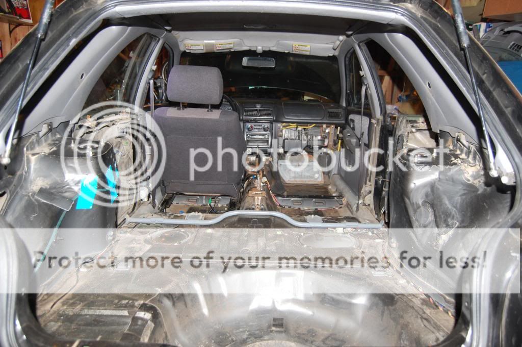

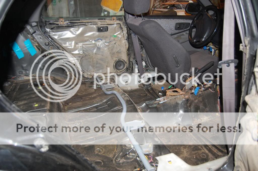

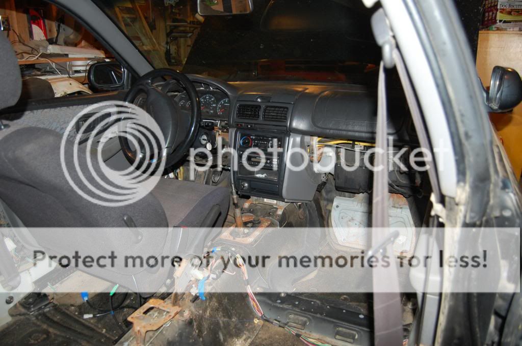

With the temporary motor in, I set in to removing the interior of the Impreza. I also began some intense research at several Subaru specific internet forums, including:

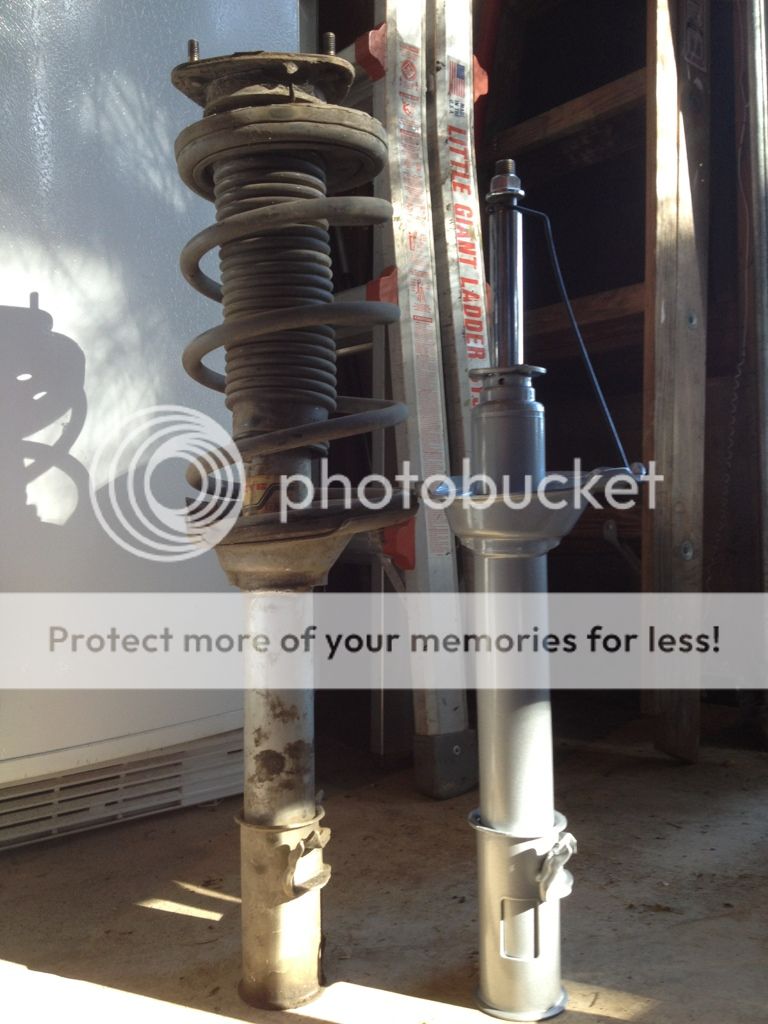

I still didn't have my overall vision, but it was beginning to gel. For the M1K, endurance and reliability are paramount. I also knew that I wanted some increased ground clearance. The Impreza Outback Sport is the tallest stock Impreza there is. And the quickest way to increase ground clearance is with a strut swap. Forester struts will bolt right up with very slight modification, so I picked up some new Forester Struts.
This photo shows the higher spring perch of the new Forester strut, of course I can't find the photo with strut rod extended as it is much longer. Yes I said strut rod.

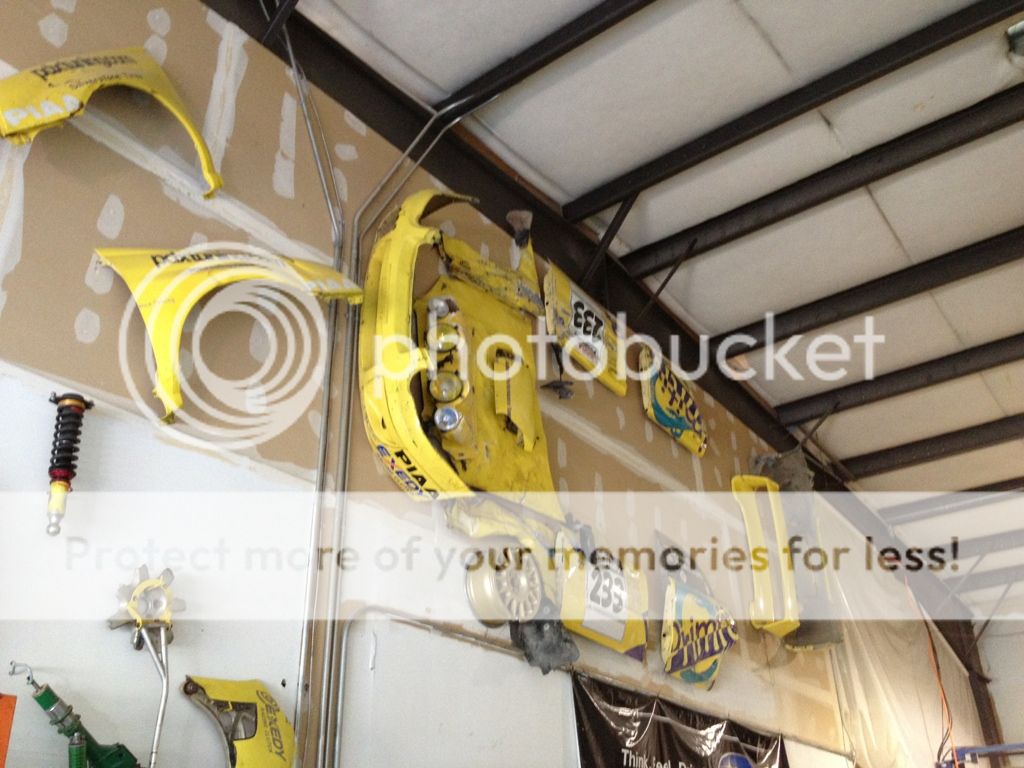

I also picked up front and rear skid plates from Primitive Racing. The Pacific Northwest is a Subaru Mecca, and with the salt-less roads, they just last longer out here. Because of this, there is a whole local cottage industry surrounding Subaru's. So, instead of just looking at the skid plates online, I went to their shop and got a first-hand look at them and a cash discount! I also got to pick their brains about some other stuff and gawk at their rally cars for more ideas.
This is one of their rally cars that I got some ideas from:
Just love this exploded Impreza on the wall:

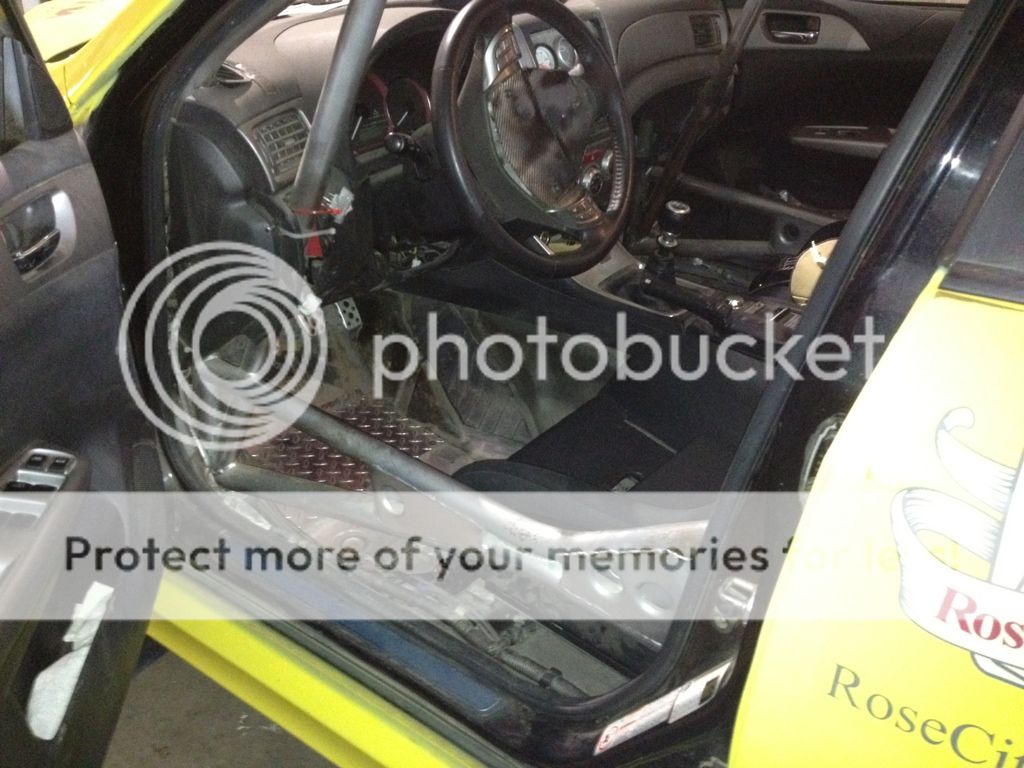

With the interior nearly out, I picked up some very sweet 2008 WRX seats. They were beautiful. I was in love.
That is, until Luke pointed out that the NORRA rules specifically prohibited OEM produced seats and required race seats manufactured by a recognized company. Damn. Well, I found some barely used Cobra seats, which were FIA certified and would exceed the NORRA requirement. Of course, they will not be anywhere near as comfy as those beautiful WRX seats, but theyd be legal and could accommodate the required 5 point harness and ball-pinching submarine strap. Pictures to follow
Ray and I discussed the cage a bit. Because it is my wife in the passenger seat, it is important that the cage be the best it can be. I also wanted the car to be able to be rally road booked so having a certified cage is going to be important. This will give you an idea of what we are talking about: Roll Cage.

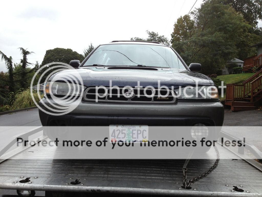

I started to take a good look inside the car. It started feeling smaller and smaller for what I was going to be putting inside it. I also started looking at increasing clearance and travel and was basically scouring CL and the COPART auctions looking for another wrecked Forester. Honestly, a Forester would have been the better choice for this type of race. More room than an Impreza, and the undercarriage is completely compatible with most aftermarket parts as the Forester is basically a taller Impreza. But if Im being honest, I think the Forester is one ugly car. Not the newer ones, but those original first few years...the ones I could afford....U-G-L-Y.

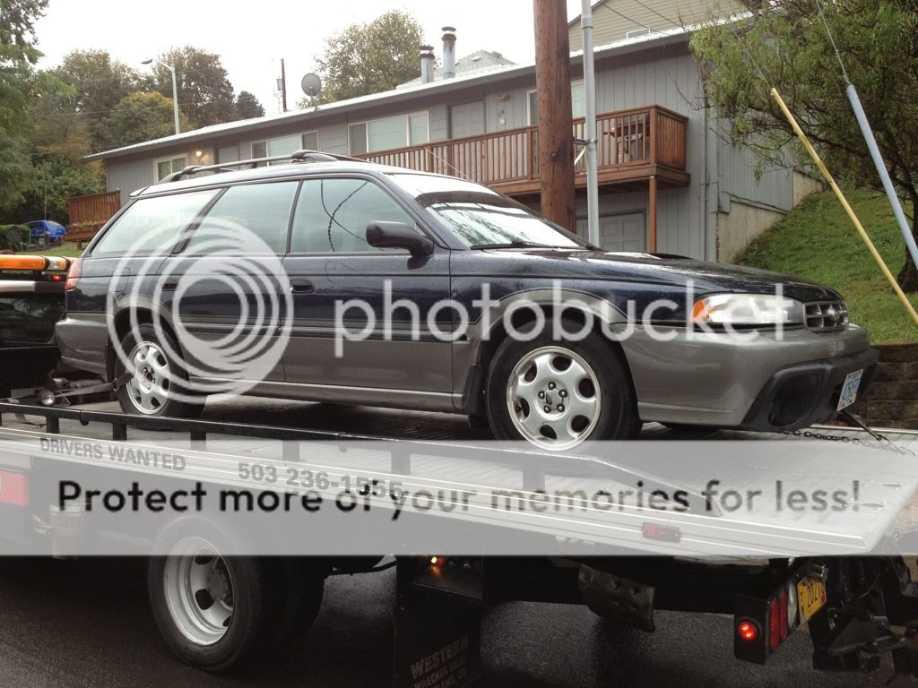

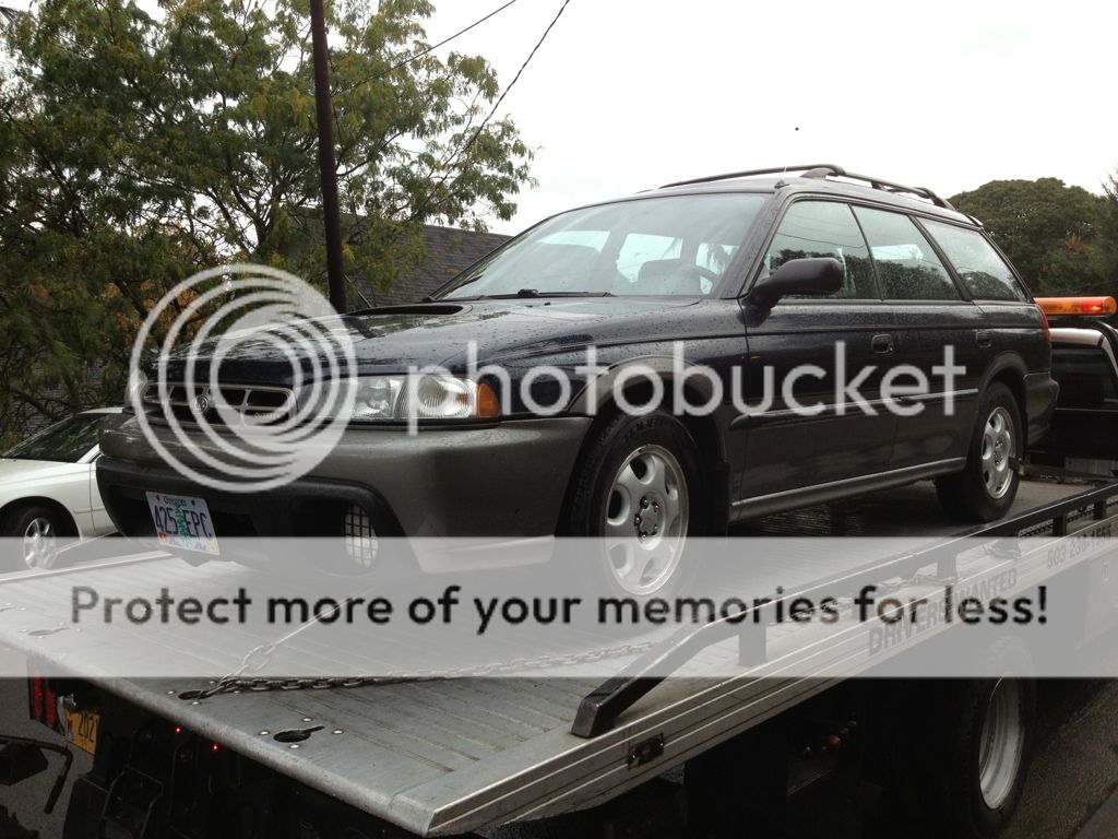

Finding wrecked Foresters is not an easy task. The Legacy Outbacks were plentiful though, and I decide that the suspension components and rear disc brakes I wanted could be found on the Outback too. I found one for $1000 bucks, but he said hed take $800 if we showed up today. It was 2 hours away, so I called David and he ran down to take a look. I told him if he thought it was good to buy it. He did.
She had a reconstructed title, some body blemishes and some rod knock. I didnt care about the title, or the blemishes, and David was going give me $300 for the motor to rebuild and sell, so $500 bucks later, the car was mine.
After Dave gave the Outback the once over he said to me, this looks like a pretty good car...maybe we should race this one. I thought about it and said, well, it already has the base suspension components I was wanting to mount on the Impreza...already installed...saving me weekends of work. It also had much more room for the cage and all of the other goodies. And let's face it, Impreza rally cars are a dime a dozen....Legacy Outback rally cars?? Not so much. Why? Because they don't make good rally cars. Much the same way that 1972 Honda SL350 dual sports didn't make good Baja racers.
