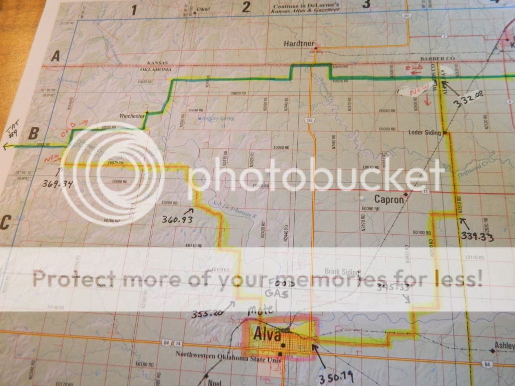

I'm a big fan of the DeLorme Atlas',and even more of Bench Mark Atlas' that only cover out WEST. I strarted with Sam's TN maps and converted them into the atlas with a colored marker (this is a Bench Mark Atlas).Photobucket

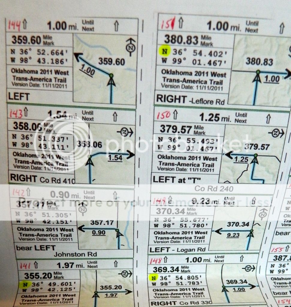

I came up with a system that seem to work well for me. I retraced Sam's maps into the atlas' and where ever he placed a milage marker,I did the same in the atlas,and on the roll charts indicated by a highlighted yellow mark at the appropriate milage marker. I also numbered each state turn by turn on the roll charts with a red pen starting from 1 to? This matched up with each turn on the gps. This was very tedious,but here is what I accomplished. I plan to predominately follow the gps while I ride,but what if the gps dies,or I want to confirm info with the roll chart? By having those corresponding numbers it allows me to roll the roll chart forward at my leisure,(not turn by turn). If my gps says 138 Rt; 156.72,then that means on my roll chart -at the 138th number that I wrote with red pen I take a right,and the overall accumulated milage is 156.72 miles that is shown om my maps as well.
PhotobucketPhotobucket
To help on the gps end-I used a RED rectangle to always indicate the mile markers that are on the maps/roll charts.Photobucket
