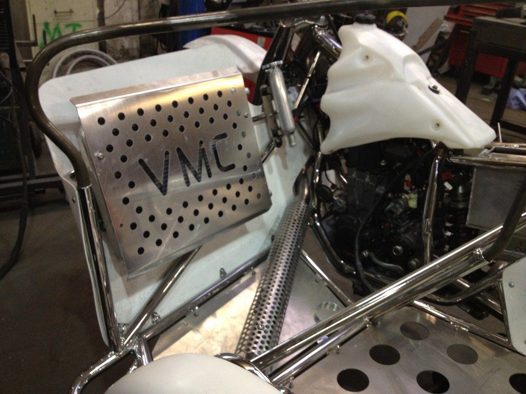

The 690 sidecar is nearly complete in the fab shop at Abbotts Farbrication,and all the works is nearly done.An new airbox was fabricated to hold the UniFilter and the battery,the exhaust header was routed to the silencer and a mesh guard fitted,the car size radiator was mounted along with the header tank,and a neat VMC rad protector was water-jet cut from 3mm aluminium sheet to finish the whole thing off.
Next on the list is to complete the wiring harness connections,and get ready for the MOT test to get it road-legal.
