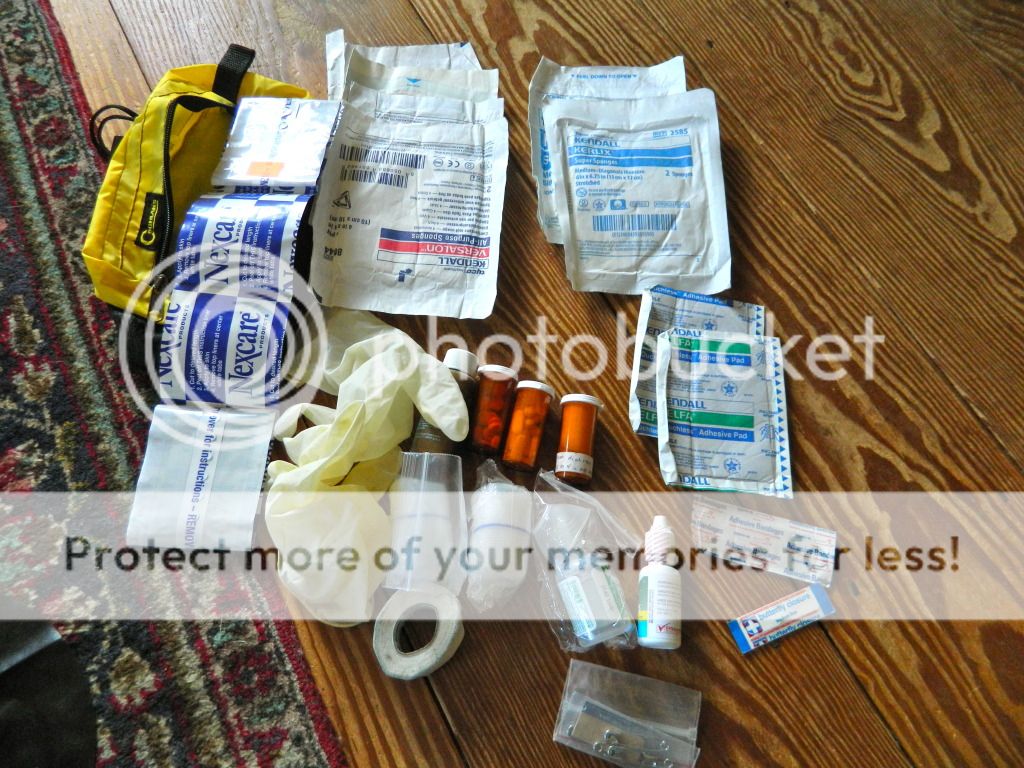

As a Firefight I feel comfortable knowing what to take in my first aid kit. Just basic stuff I use every day in the streets. Anything more than lacerations and gross bleeding-your screwed. lol
