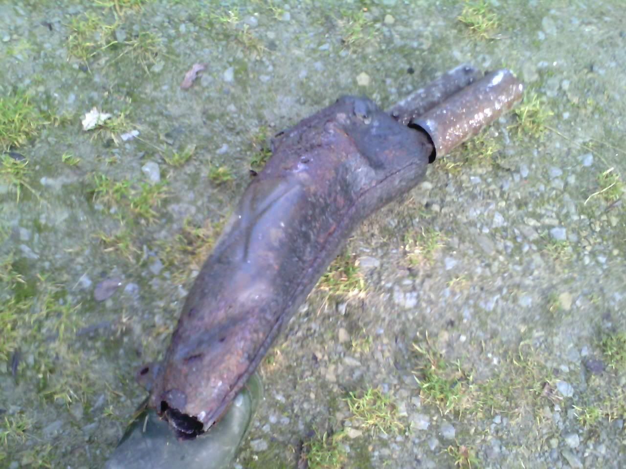

the transalp exhaust was rotten and i'd always planned for it to go, bit when i removed it actually broke off from the header!
especially pleased with the replacement titanium Gixxer pipe for 11.20 delivered! half the weight too at only 3kg
