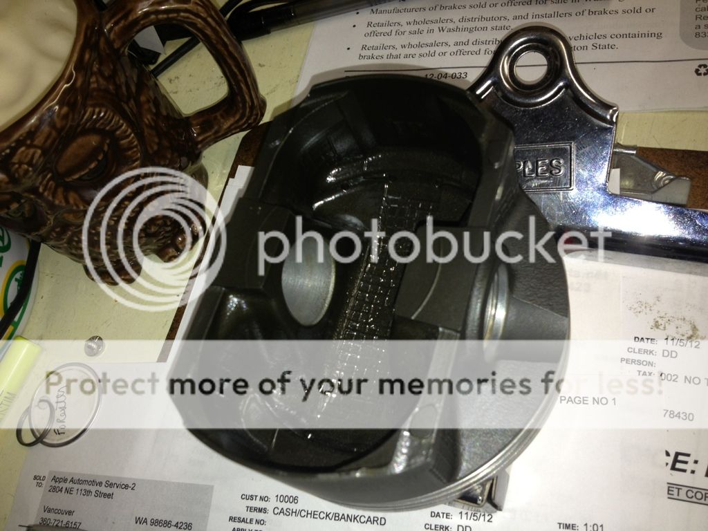

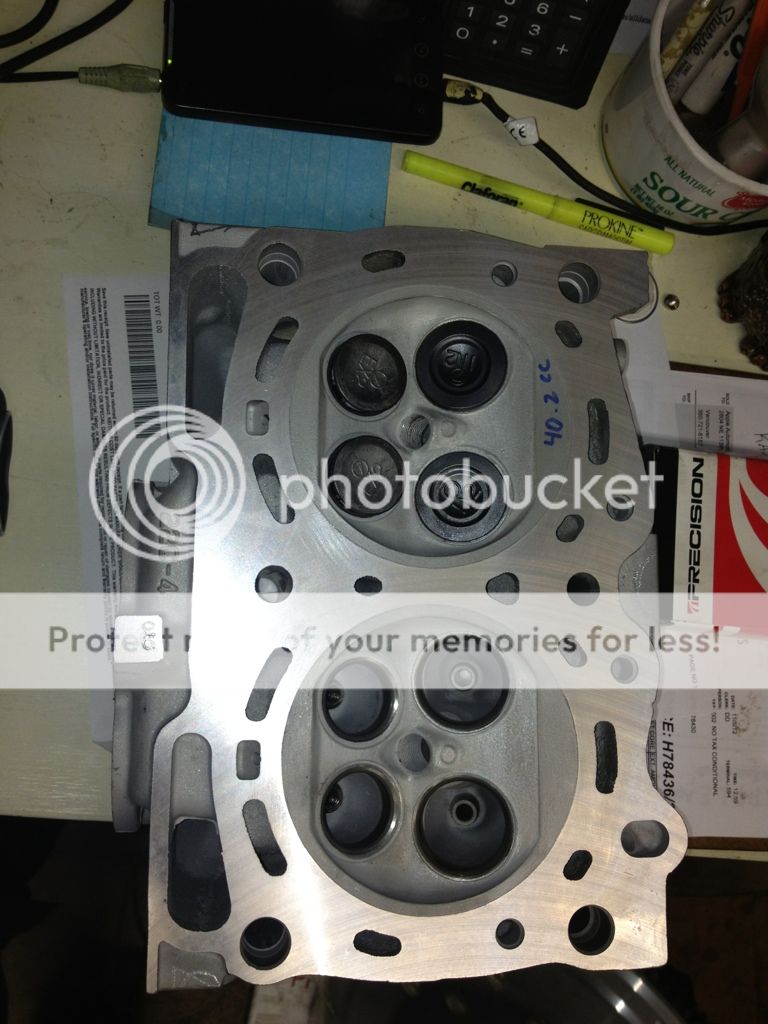

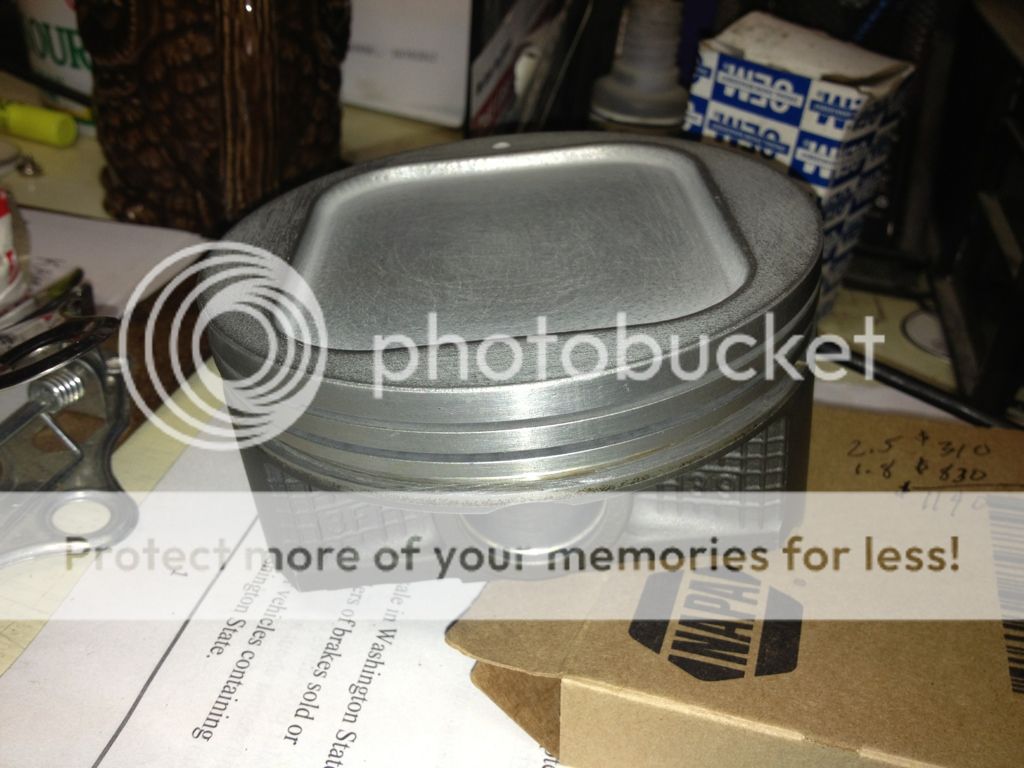

Here's some more pictures of the coated stuff, the pistons each have three different coatings exhibiting different characteristics. David would have to elaborate on this. I hope to have Dave also talk more about the Lego aspect of Subaru motors as it is pretty damn cool and is part of why there is such a cult following for Subarus.
