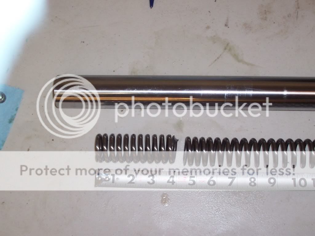

The next step was to lower the front end as I wanted to lower the bike at least 4".
When I had the forks apart and cleaned the sludge & slurry that used to be fork oil out, I replaced the bushings and seals and then I cut 4" off the end of the stock springs to make them stiffer and to drop the front.
I cut the top where the tighter coil spacing of the progressive rate springs are. I then placed a 4" long spacer on the damper rod to limit the upward travel.
This is the difference in length of stock and shortened:
Yes, 8"!
However that is misleading because the stock forks sagged 4" under the bike weight without rider.
The forks now have 6.5" travel and 2" sag with me on it.
I also replaced the ugly fork boots with neoprene skins
