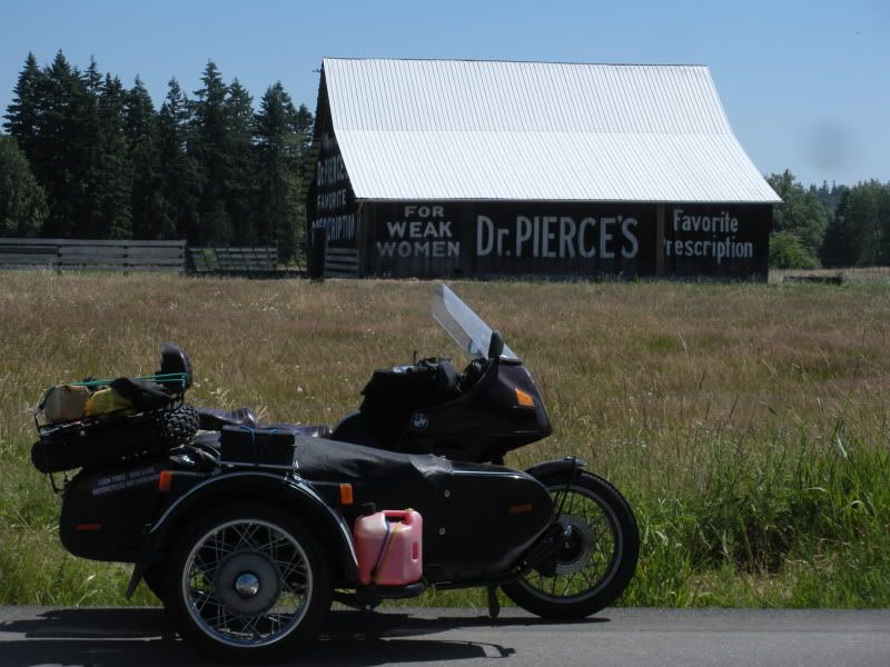

Sounds good! ...here's mine.
Ural tub, Lowell Neff subframe, dual brake pedals (rear/hack) and a unit leading link - otherwise pretty much the same, eh?
