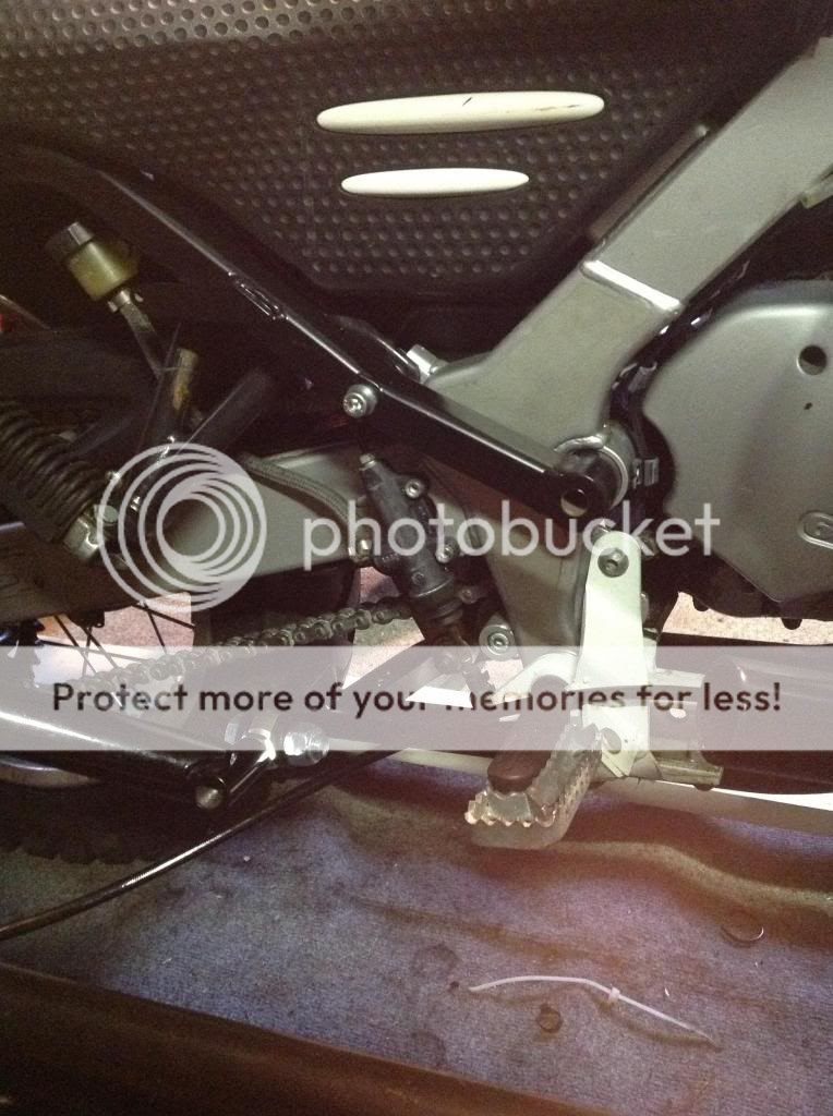

Subframe in
Upper frame mount.
Won't need this anymore.
