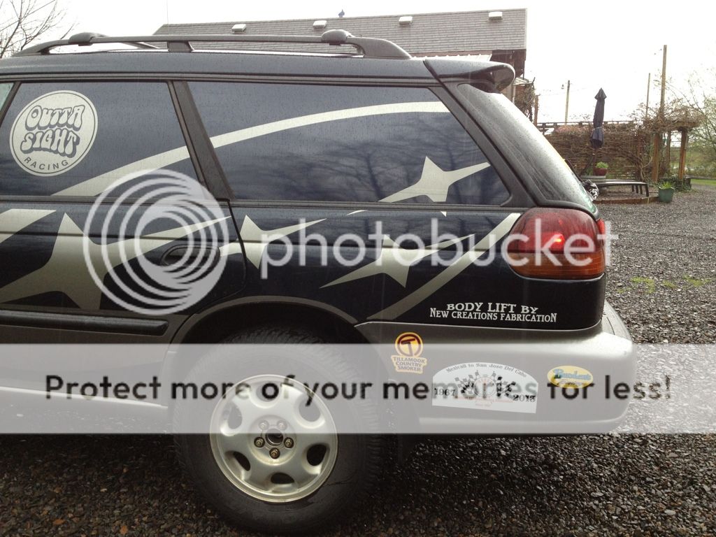

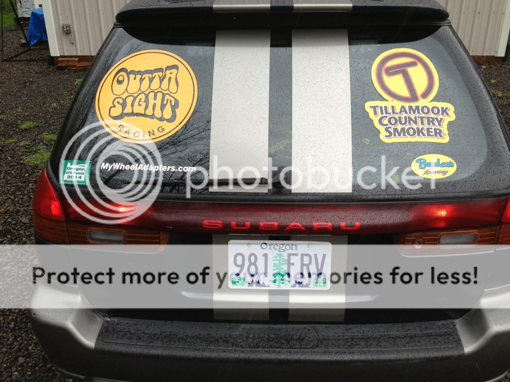

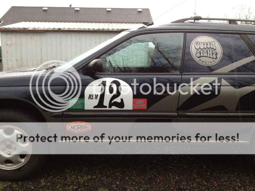

When I ordered the door decals..I ordered them too big. They were not going to work. Luckily, Lonnie is the man, so he did some cutting and came up with some great solutions. Using elements from the original decals and some he made up, we now have most of our numbering and graphics done. There are still a few things we will be doing and sponsors to add.
The RSM in front of the 12 is the NORRA class I am running (Rally Stock Medium) and it is required to be there.

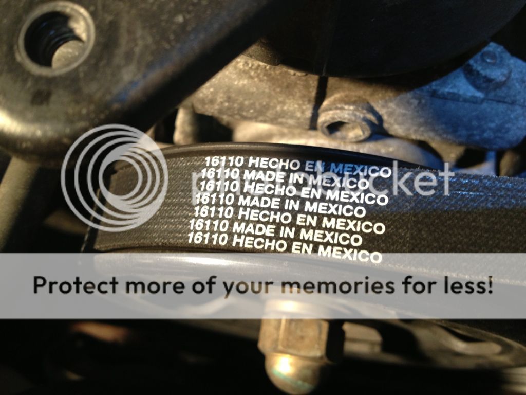

We also keep adding more Mexican components to the car to help get it acclimated for the race...
