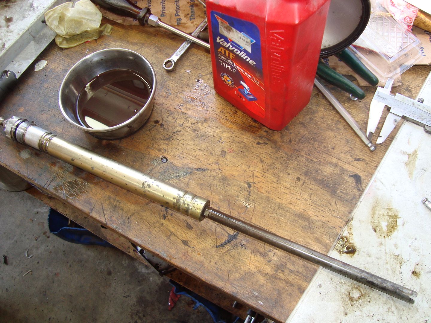

Dismantled the forks and steering head.
The forks were to use a local expression munted.
chromed needed doing, new cartridges were needed, and so on....
I put them back together in the mean time.

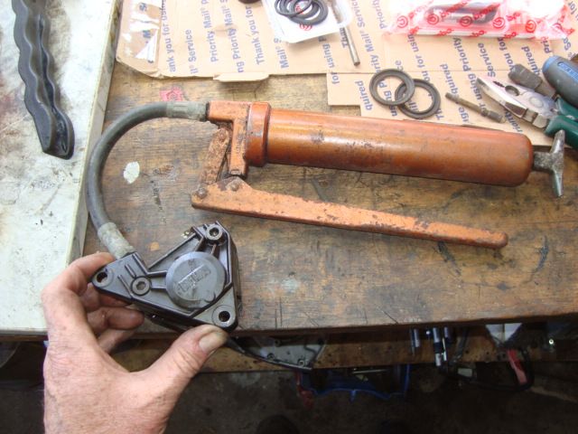

There are 3 brembo P05 calipers, small versions of the ones used on Ducatis and big block Guzzis ( Guzzi jargon )
The local Guzzi guy said there are no parts available, the internet suggested otherwise. Steve at Bevel Heaven had all the parts as Pantah use them too.
The pistons did not want to come out after 10 years of sitting...
Used the old grease gun trick and they came apart easily.
After rebuilding the calipers I put the whole thing back together and got it running and rideable.
