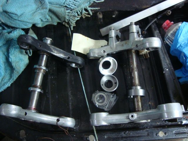

Well....the Monzas spaghetti 32mm forks were pitted and the cartridge stuffed, as were the bicycle cup and cone steering bearings that are bike specific and expensive.
It nearly became a blanky bike ( pushed into the corner ).
Unfortunately its hard to move bikes with no front suspension so on the lift it stayed....and stayed.....
My Engineer made me a few bits and I found some bits on Ebay as the local Guzzi guy has bugger all V50 stuff.
Picked up a set of 35mm forks that by good luck came with the triple clamp with longer pin.
Engineer made me a cup/cone/Taper conversion, using some drawings off the net done by an Aussie bloke.

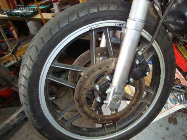

Now the forks are 20mm wider spacing than before....so the discs need to be spaced out.
Of course the axle was longer.....Ebay again......even found some Konis for it.
Engineer knocked me up a new spacer for the axle....
Bunged in the battery, hooked up the wiring and it started. Checked all the bits I had changed and took it for a spin.
