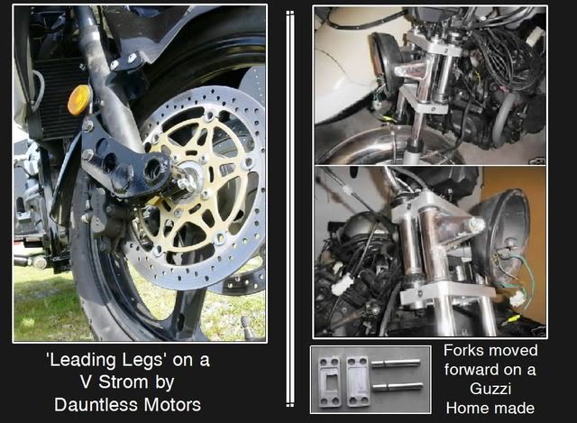

Originally Posted by claude
Just some quick thoughts:
*The shorter the leading link swingarm the more rigidity it has.
*Shorter means less unsprung weight.
*Shorter means that possibly lighter material can be used.
*The shorter it is the more trail varies in bump and rebound (maybe only In theory related directly to the front end itself).
* Some short ones use a bent swingarm to facilitate the use of a longer shock
Curious about the chrome if that is what it is. Google 'hydrogen imbrittlement'.
Is this a picture of what you were looking for?
