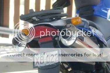

Fit up a nice after-market muffler and ebay another one and turn it into a tool canister like the Microns on my Dakar. $300 all up, lost weight, sounded better, went heaps better and no cat to poison.
They are definitely nice looking pipes. I noticed them on your earlier pictures. Unfortunately I’ll have to get 2 of everything. Down side of his and hers bikes. So I have the same problem as Kovrob.
Plus, what is easier than drilling out the end cap hole and closing off the connection pipe. IF it’s as simple as that. If it’s not, I’ll have to decide whether of not to go the whole hog or to reinstate it.
Couldn’t really care less about the cat. It’s the can I’m after. I realise in litres it’s not a big amount, but I should be able to fit all tools and spares for a big trip in 2 of them. That would make my life a lot easier. Keeping in mind I don’t have these to go hard on, but travel on.
Kovrob, cheers for the heads up on the right hand side can. Presumably it’s only spot welded. I’ve got welding equipment but only a cheap Arc welder. My mate has a fabrication company so I could hit him up for some help if I get stuck. I could always get him to weld me up a pipe to fit the original end cap on. Should have a go on my own first off course.
Not sure on the clogging. I know that people have don’t a fair few thousand k’s on leaded fuel with the can in. Which makes me think it won’t clog. The lead will brake down the chemical coating on the mesh or whatever you call what they build a cat out of.
I didn’t like that idea about the heated wires either. Hence why I just re-wound the heated wire the other way and let if come out the way all the aftermarket guess have it.
