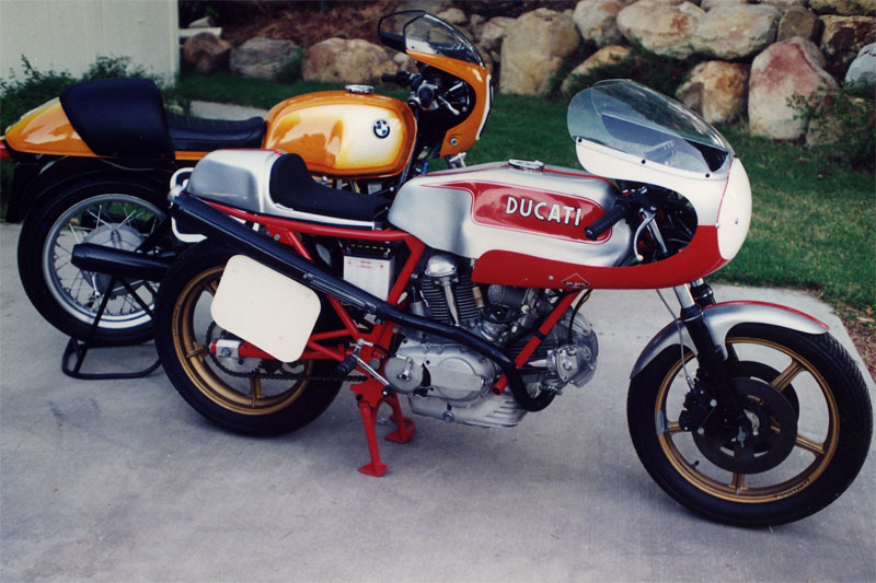

old piles -- BMW variety
http://www.advrider.com/forums/showthread.php?t=244174
http://www.advrider.com/forums/showt...ight=superbike
From Motorcycles II
I owned/restored a couple of these old bikes and have a lot of photos in my picasa site below........details about McLaughlin's bike in the links above.....Bruce
