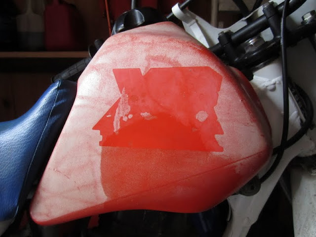

May depend how much faded. Holy cripes do I have something here to practice on.25 years of fading. And have already practiced but not with 303, looked a couple weeks back and price was a little rich for me. Maybe next time....! But sure tried the others....Armor All, Mothers etc....etc nothing worked.
In the meantime I tried another trick I may just have learned here. Brake fluid. Now that's DOT4. Apparently the DOT5 is better for that, has sillicone in it but again local price was a little too much if just for practices.Maybe next time....!
Anyway you can see where I removed the Honda decal and then tried Dot4 under. May need a little wetsanding at the appropriate grit(s) lubed with brake fluid. This is just a quick buffing with a dirty rag and older brake fluid. Been like that for over a year so seems to work. Maybe someday I'll finish it, that is put more than 5 minutes of efforts into it.
Sure doesn't look like the Glycol ate the plastics. Never tought it would but......I have another tank for that bike.
Have tools, will travel!
