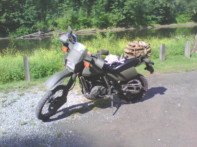

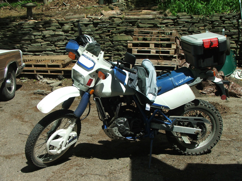

Done (sorta)
I've been working on my 90 for a while, wanted to paint it and had an issue where it would quit in wet weather. Thanks to some folks on here, I tried several different things and the problem is gone. I bought the bike in Sep 08, rode it all over and was pretty happy with it. I'll list what I did to it, then some pics.
New fork seals (I was being a puss about this, making a mountain out of a molehill, took me maybe 30 minutes once I actually did it)
New plug boots, seals, etc.

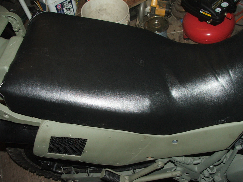

Repacked/rebuilt the muffler, and lowered the mounting by 1 1/2". The side panel and rear fender were badly burnt and melted by the leaking can and the tip rotating and pointing directly at the fender.
Added a piece of metal on the rear fender where it melted, cut out the slotted area in the side panel, filled the hole with some mesh, and put a better heat shield inside the panel.
Cut a Thermarest Trail seat into the seat foam, added about 1 1/4" of foam on the sides, and recovered it. I screwed up my first attempt, but I'll ride it for a while to see if I want to make changes before I cover it again.
Removed the side stand switch.
Still to do:
Fab new windscreen, 1-2" taller.
Paint my rubbermaid top box and remount.
Make/buy a waterproof mount for my radio.
Same for GPS.
And some pics- what it looked like before I really started, I had stripped some of the decals off, especially the tank.
And now:
Closer shot of the seat and side panel:
Anyway, been riding it for a few days and I'm really tickled. Thanks to all who contribute to this thread, keeping a 20-year-old thumper running is a full-time job (at least it seems like it). I expect the paint to chip and scratch, but touchups are cheap.
