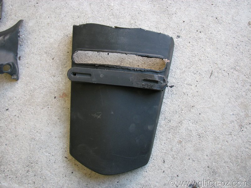

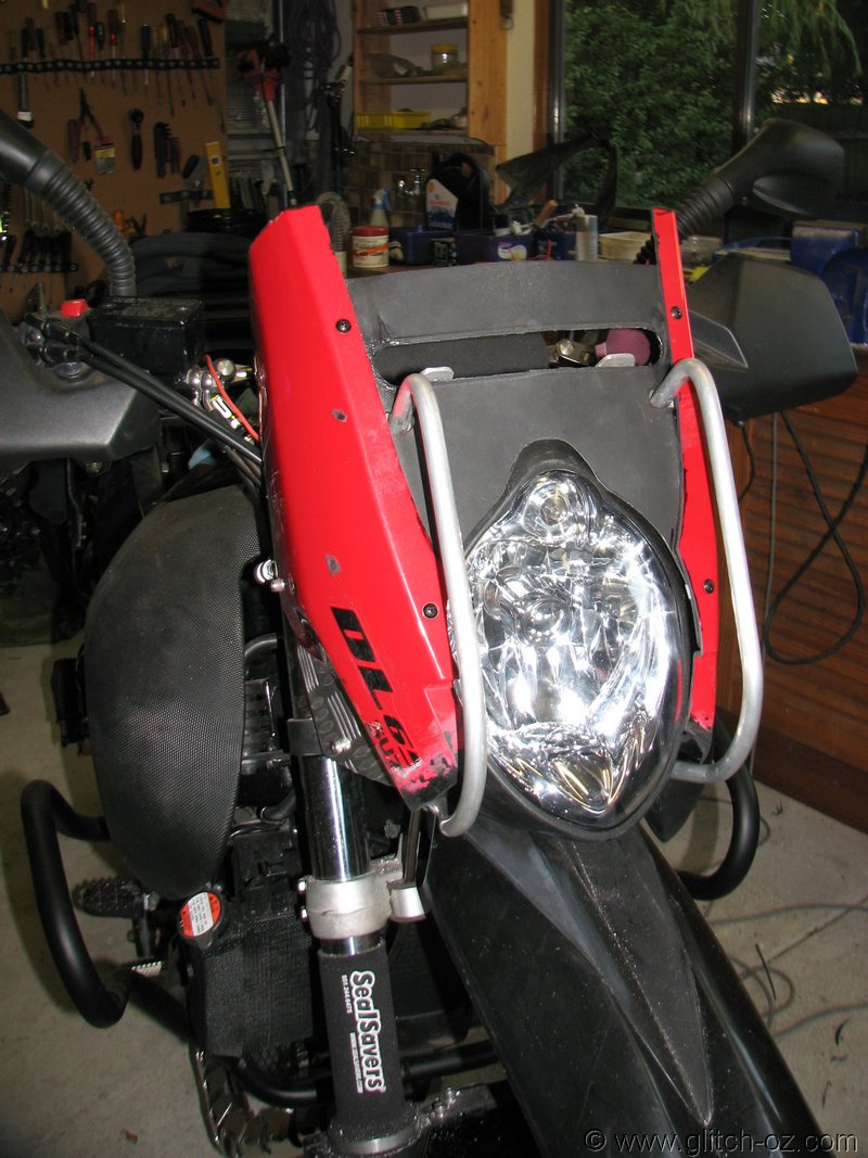

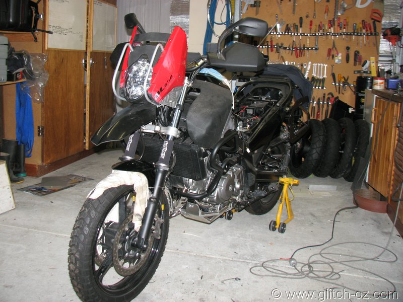

Originally Posted by jdrocks View Post
yikes, a KLR rear fender on the front of a VStrom, what's the world coming to?
Right you are!!
Here's a part of a Strom rear fender on the front of a......whatever.
Gladius Headlight, modded KTM- high guard, cut-down and bi-sected OEM front guard mounted to forkbrace
With alum-mesh infill-cover....the mesh will be black in the end, like the checkerplate-cheeks.
Work in progress......s l o w progress, that is
Love your work, mate....AWESOME!!!
Cheers
pete

Originally Posted by glitch_oz View Post
Right you are!!
Gladius Headlight, modded KTM- high guard, cut-down and bi-sected OEM front guard mounted to forkbrace...
sometimes i think Oz must be the center of the universe for rat bike builds. you guys see a part and think "hmmm, i can make that work." high/low fender setup, we're thinking along the same lines.
what material is used to fab the "cheeks"?
jdrocks is online now   Reply With Quote

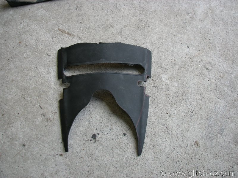

Underneath it's the OEM ABS- panels, cut'n shut muiltiple times and heat-moulded around the tank-cheeks.
Filled and smoothed with contact-glue bonded heat-mouldable EVA (the mid-sole material of your Nike's etc), finished off with a contact-glued marine-vinyl (diamond pattern, often showing up as c/f in photos).
2-2.5 full days of work in a pair.
Cheers
pete
