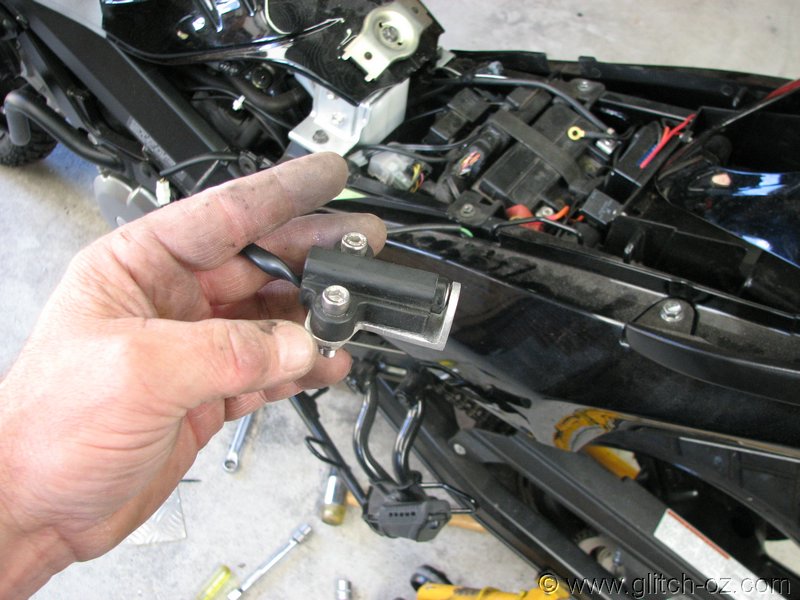

Originally Posted by Burren Rider View Post
Getting rid of the sidestand switch (as they have been prone to failure on my dirt bikes in the past) would be good though? Surely the sidestand sensor wouldn't be wrapped up in the mapping
Hi Danny
Love the thread...great posts!!
Thanks for the effort taken
Re: sidestand switch...Rather than bypassing the switch, how about just re-locating it.... out of harms way, that is.
Like this perhaps (on a DL)
Didn't mess with any electronics to just make a little alum bracket, bolt the switch onto that, then re-route the cable to make the whole shebang sit unter a side-panel, away from sticks and mud.
Cheers
pete
