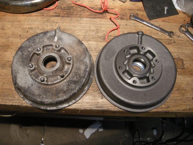

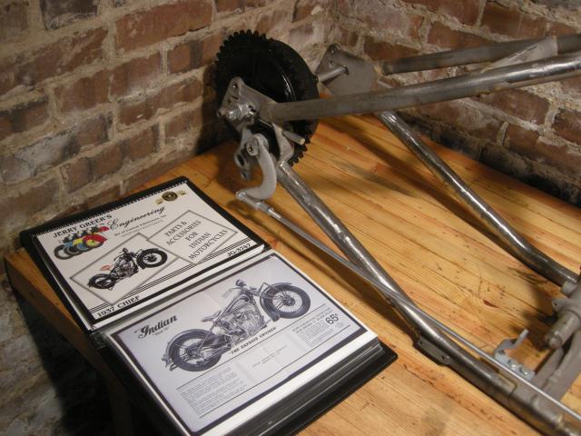

I consider one of the first milestone for bring a bike back to life is to getting it rolling. And the brakes and axles are the first step. In my case my project came with a complete rear drum assembly.

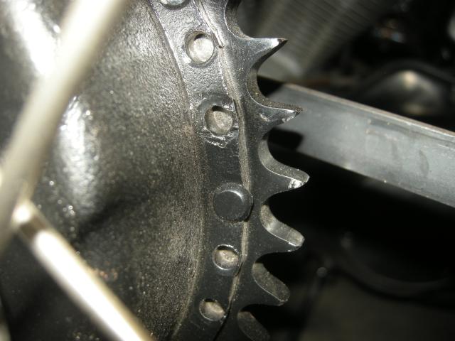

The sprocket for an Indian Chief is riveted on the drum. When the rivets loosen up the holes tend to wear out of round and the simple solution is to drill a new sets of holes. The drums I received had been drilled twice. And a fresh sprocket had been installed.
Unfortunately the bike didn't come with a front drum. 1937 was the first year of interchangeable rims. There are lug nuts that secure the Hub to the brake drum. In 1936 the drum and hub were an integral part. In 1938 a set of pins were added to lock the hub to the drum to added shear strength. It is important to be ever so vigilant and tighten the lugs on a Indian frequently. It is common for riders to loose all six lugs on a wheel. In the case of a rear wheel you won't be going anywhere if this happens since the sprocket is attached to the brake drum and not the hub.. And in the the case of either wheel you will loose your brakes on the wheel. So I started hunting for a front brake drum in the spring of 2010. The best I found was a brake drum for a side car but the threads were reversed for the bearing locking threads and I wasn't sure this would be an issue. So I kept looking. I found an original 1937 drum and bought it but it turned out to be worn beyond serviceable limits. I then came by 1938 drum and bought it. The hub would cover up any 38isms.
Now after a year searching for used brake drums. Todd at Jerry Greer Engineering came out with New reproduction front and back brake drums which are spot on. I was in a hurry to hit my first mile stone, if I only would have been a little more patient I would have saved lots of time and money and had better brakes. So I've bought the reproduction front and back drums and I'll be selling the used ones I paid top dollar for. Which means I bought high and will be selling low. Next Posting: IronHorse Fenders and Tank.

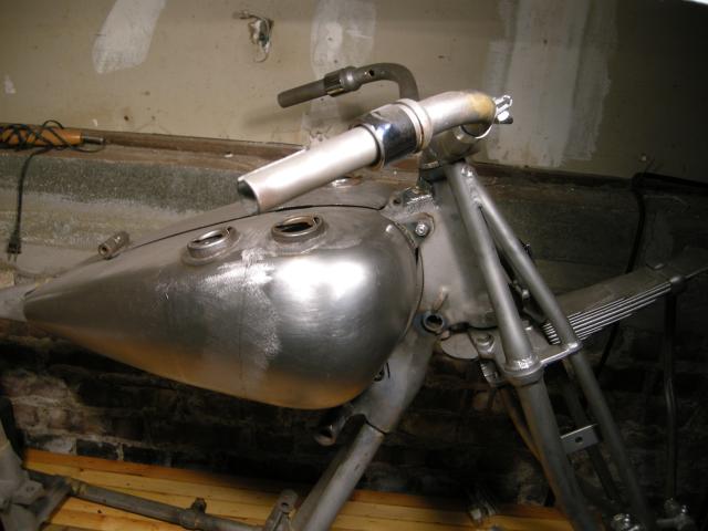

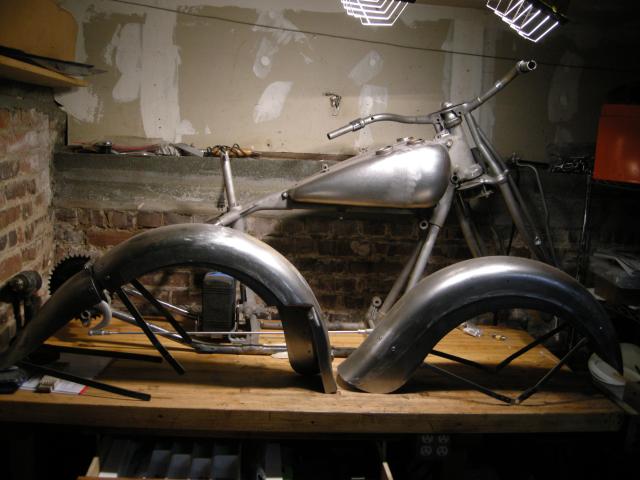

Tank and Fender

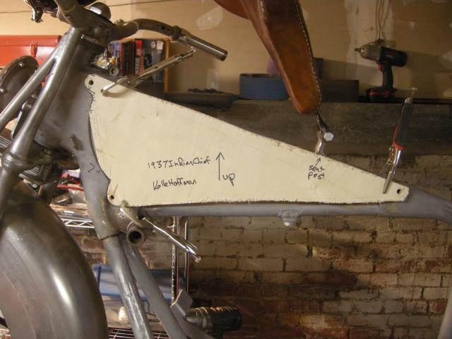

My project came with an original front fender and a back fender. The front fender was much better suited for a patina bike. It was pitted and the sheet metal was anything but straight. It was orgininal which started me down the path of looking for original sheet metal. I didn't have correct tank for a Chief and the rear fender was more likely for a Scout or Four then a Chief. So I turned to plan B. All new sheet metal from Matt Blake at Iron Horse Corral (http://indianfenders.com). Matt's work is amazing. The rear fender fit like a glove and the front fender looks wonderful. I did note that the front fender was a bit narrower then the original. This ment that there was a gap between the front fender and the fender brackets. On my bike this was resolved by welding new brackets on the front fender to take up the space. I could have easy added a 1/16 shim to take up the extra space. Now when I see preskirted chiefs I always not if there is a gap between the fender and the forks.
Originally gas tanks for a Chiefs were soldered. And after 20, 40, 60 + years the solder fails. John Bivens (Indian Engineering -- Stanton, CA) will rebuild tanks. He unsolders them, has the clean up, tinned and resolders them. The alternative is steal welded tanks is a very smart way to go. Most the experienced Indian folks I respect advised me to go with steal welded tanks. So that's what I did.
Well I ran into a small snafu on the tanks I ordered from Matt. The location of the mounting holes on my frame didn't line up with the fixture Matt uses when assembling his tanks. Matt guarantees the parts he sells will work and he stand behind is work. After a call to Matt describing the problem I encountered he suggested I make a fixture which matched my frame and send the tanks and fixture back to him and he would modify the tanks to fit my bike. Two weeks later I had my tanks back and they fit like a glove. It's really hard to say what a 75 year old frame has gone through. But my frame likely had seen quite a bit.
I sold my original fenders on Ebay. I was hoping to sell them for what I paid for Matt's fenders but alas I only got just under half of what the replacement fenders cost.
The oil and gas share the same tank (right) on a Chief with a divider of course. The gas is used as heat sync for the oil and helps to cool the engine. The story I heard on this bike was that the right tank was filled to the top and boiled out while being ridden. Fire extinguishers were present and exhausted but offer little relief for the enviable. Worst part of the story is that it was a borrowed bike. What a pity.

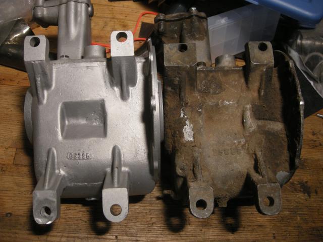

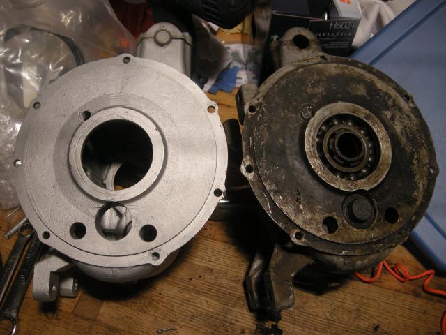

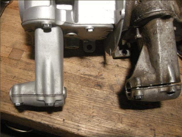

Transmission Cases

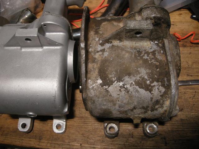

The design of the three speed Indian transmission changed very little from the 1930's until 1953. Externally the case were beefed up in the early 40's. This meant that I need the less reinforced design. The transmission case on the left (clean) is a late 30's "ridge" case and the transmission on the right (dirty) is a post war transmission case.
Note the reinforcement band on the right. A common place for these transmission cases to crack is below the rear mount. Likely from the rear mounting bolt loosing up and allowing the case to pound against the frame.
Note the beefed up upper left mount on the right case. This would interfere with the chain guard on a 37 chief.
Not much different here. Note the mounting hole on the flange in the 5 o'clock position. If the mounting hole is in the six o'clock position that indicates the case is an late 20's / early 30's case. Also note the two holes on either side of the lower large hole. They allow oil to pass freely between the transmission case and the primary. In a 1940 case these holes are absent to allow running different oil in the case and primary. Some plug these holes so that they can run a lighter, multi weight, oil in the primary (10w-30) and heavier oil (50) in the transmission case.

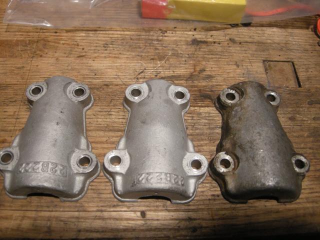

Note the reinforcement buttress on the right on the tower.
The tower caps differ slightly as well as the location of the number on the casting.

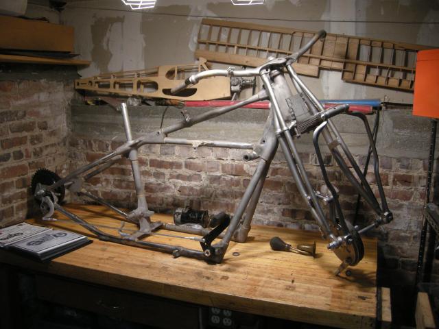

Hi Kalle,
Fun thread, thanks for posting!
Here's a pic of Kalle's 1937 project:
And one more:
