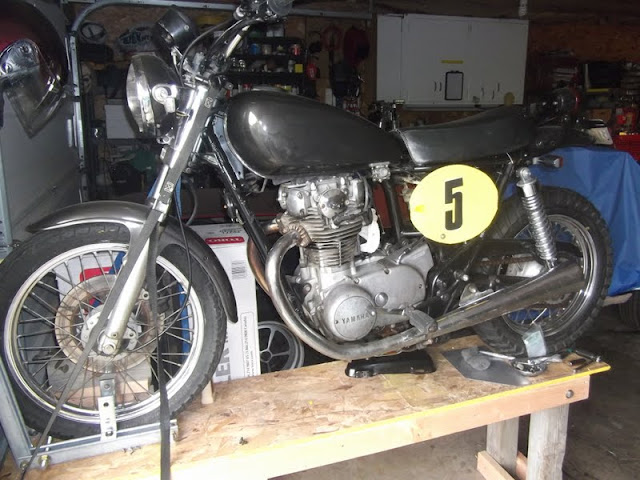

keeping busy
Did a bit of work on the 79 Special , fitting a Spirit of America , Eagle sidecar . All the old fittings had rusted out and had to be remade . The frame is rather small and it was a struggle to fit the mounts and leave room for the exhaust and still be able to kickstart the bike
Getting the mounts to clear the exhaust can be quite a chore. I think I am going to run a set of pipes that exit the left side from GordonScott to eliminate the problem.Just cant decide if I want to go with high-pipes or a 2-1 low setup.
I am getting close to getting my sidecar rig ready for the road. Most of the fab work is complete. I just need to bolt the carbs on and beef up the front forks. I cant decide what to to about sidecovers. Number plate or the originals? What do you think ?

The copilot is getting impatient !

[QUOTE=Furious D;18538887]Getting the mounts to clear the exhaust can be quite a chore. I think I am going to run a set of pipes that exit the left side from GordonScott to eliminate the problem.Just cant decide if I want to go with high-pipes or a 2-1 low setup.
I am getting close to getting my sidecar rig ready for the road. Most of the fab work is complete. I just need to bolt the carbs on and beef up the front forks. I cant decide what to to about sidecovers. Number plate or the originals? What do you think ? ---------
The number plate looks good !
Left side exhaust makes life easier for sidear mounting ,that's for sure .
However it only becomes a necessity if you want to attach a mounting to the bottom frame rail .
High pipes or low ?
For road only , I would go for low as it gives you better access to engine covers and carbs , panniers are easier too.
If there's a chance you would be going off road , high is the better option , as ruts would not be such an obstacle for you .
Good luck with the build !
