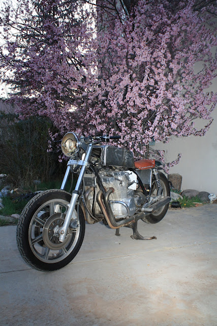

Here is a pic I took this afternoon after about a 25 mile shakedown run. It rode well, but certainly has some things still to be buttoned up.
Not much louder than an XR400, fast, and handles like shit. Hell yes!

Pretty much finished it up on Sunday and wrapped the exhaust still a bunch of little stuff and jetting to dial in. Put 75 miles on it on saturday, so far no performance awards from jonny law so that is good.
