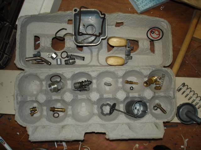

Carb cleaning day!
No problems, except I cannot figure out how to remove the insulating bushing (and washer beneath) at the head inlet side. Is it some kind of plastic or fiber? Any ideas for removing without destroying it and reusing it?

Re-mantle...
Any kind of lubrication required or suggested for any of these parts?
I'm guessing not (gas and most lubes don't mix!), but my old idle jet o-rings were toast, and I don't want to kill the new ones on reassembly...
BTW, not the best photo, I know, but this is pre-soak...

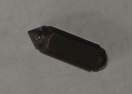

--- Finally, the float needles - they both seem to be just the same:
Where it seats is shiny, but it doesn't appear damaged or scored - to my eye, nor to my fingernail when I drag across it to feel for scoring - is that enough of a check?
