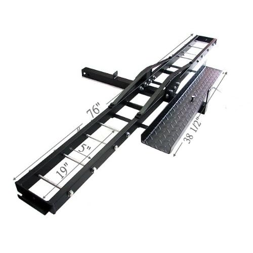

My bike has broken down and I'm off to look at an Aprilia Mojito 125 as a short term replacement. I have a carrier for the back of my car, where you just put the front wheel of the bike on it and 'drag' the rear wheel. It works great on my VN, but would this mess up anything in the auto box of the scooter???? I just seem to remember you can't tow an automatic car, is it the same for a bike?

This is my rig!
The distance is only about 5 miles.
