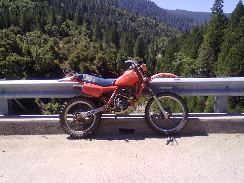

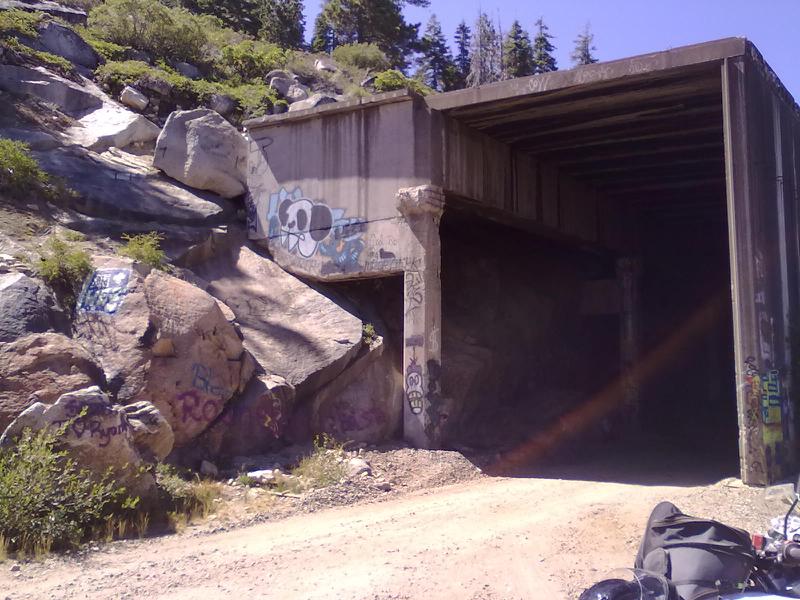

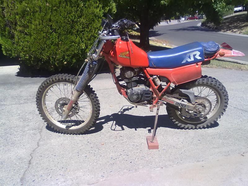

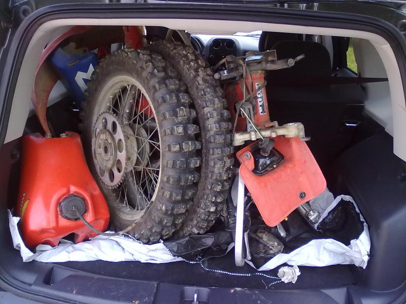

last weekend, I took my new (old) xr200r out for a 240mile dual sport ride with a good mix of street, fire roads and single tracks and railroad tunnels. it survived without troubles, so I feel confident that I now have an alternative ride, if needed.
picked up and transported all the way from indiana to california in the back of a rental....
up in the mountains
and through the tunnels
the xr200r is a blast to ride, although the stock front end is not very rigid. I'm planning a "fork" swap event soon. the xr350r will receive a xr400r front end, and the xr200r will receive the stiffer xr350 front end (and disc brake). or I might leave everything stock for that "vintage" bike riding experience...

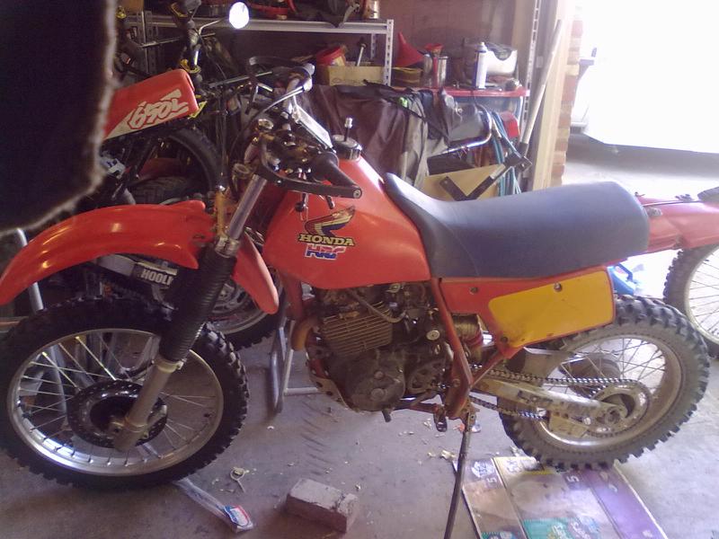

Fork Swap-O-Rama
last weekend I took some time to swap forks on my two Enduro bikes. First, I put the XR350R forks on the old XR200R. This gives me firmer forks (because they have larger tubes), about the same travel and disc brakes up front. Even though the stem bearing fit and match up, the XR350R stem is a bit taller and the threads to tighten the top bearing didn't reach. A trip to Osh to add some washers, and problem solved:
I'm going to convert these forks to Racetech cartridge emulators.
the second swap, is to add a XR500R triple clamp to the XR350R and add some XR400R forks I got off ebay. they bolted right on, with no issues. However, since the XR400R has a larger diameter front axle, the old front wheel won't fit. so I had to steal the front wheel from my bucket bike project. Still needs some brake calipers to make it work, but now the XR350R has some cartridge forks.
