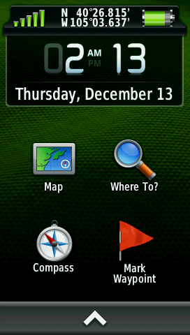

Ok I just got my Montana 650. It is still at version 4.20. I've been following along and learned how to select Fuel Services under the Where To? menu. But now I want to put it back to just show the basic Where To? icon and it makes me pick an item UNDER the Where To? selection menu. How do I do it?
In other words, how do I change it
FROM THIS: TO THIS:
Also do you recommend I go to the latest version 4.60 right away?
p.s. anybody want me to post a screen from 4.20 first? if so be specific and I'll find it for you.

snooker, I know you already know about the Montana wiki, and have followed the setup process here.
To get the "Where To?" icon back, select Setup -> Main Menu -> Add Item -> Applications -> Where To?
p.s. - I would make a full backup of your Montana as received, and then update to v4.60.
