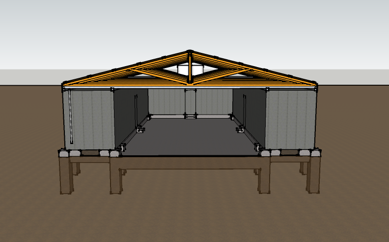

No experience, just thinking about one made of storage containers. Simple and quick.
http://www.zoklet.net/bbs/showthread.php?t=72150
WOW, I've never seen anything like these. I can't put a car lift in those containers BUT I like the idea.
You see folks on "American Pickers" using these to store stuff but I've never seen them used like this. This is WHY I asked the question here. DIVERSITY! They talk a lot about diversity at WORK but don't really mean it but I do. EVERYBODY has a whole DIFFERENT set of life / learning, etc. experiences that THEY alone bring to the table that helps them to think differently about EVERYTHING!
"I" don't want to reinvent the wheel SO that's why I'm asking for ANYONE and EVERYONE to help me out!
THANKS for the ideas !

If you heat with wood, you've gotta love this!
Wood is under cover, backed up to a steel wall that can't be infested by carpenter ants (or worse) - it's brilliant!
One thing I wonder about these containers though - do they trap humidity and become rot and mold factories?
HapHazard is online now   Reply With Quote
Old 01-05-2013, 03:59 PM   #38
stainlesscycle
stainlesscycle's Avatar
Joined: Jun 2008
Location: morgantown, wv
Oddometer: 1,638
simple solar ventilation fans could solve that issue... i've considered the shipping container route in the past. that is a neat setup, for cheap...

As the containers are a "go to sea" for original use I hardly think humidity would damage whats inside? They are for sale/rent all over the USA as are old tractor hwy trailers. My local school uses 2 containers for dry storage. I really dont get them as a support for a bldg? I can see having either or both but not built together unless they were a freebie, which is unlikely. They will cost more than the materials to build the walls for a pole bldg..

Neighbor bought a container a couple years back. Don't remember the price but sure remember the clusterf....of the delivery. I don't think the truck driver was very good, he sure got stuck and it took a rather large old tractor to get him out.
Anyway the neighbor's container has a pretty nice wood deck and is vented, top & bottom. I am pretty sure that has to do with ships loosing them over the side. If sealed they will float for a very long time and I know that it is one of the biggest hazard to navigation and probably the highest rate of collisions with objects at sea....floating containers. Yep we had to go babysit a few of them many years ago until a tug showed up and dragged them ashore.
