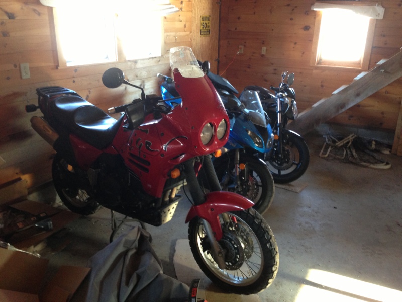

Safe and sound in Mark's barn:
It's a Steamer alright!
Yeah, that's going to need some bedliner.

Haha, those pictures make my barn look even more crowded with motorcycles than it really is. There's still room for a few more.....
And how cold was it that day? 20 degrees? Hence the copious amount of steam the Steamer is putting out. Got to say, though, I was impressed that it started right up despite the cold. Getting my Bonneville started at 20 degrees would probably be impossible.
And here it is in its final winter hibernation spot:
