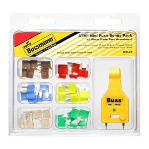

Originally Posted by divimon2000 View Post
I don't care to carry my full DVM and have seen the simple continuity checker with light is this a good way to go? I guess you can do everything you need to with that as opposed to the simple Voltage checker, yes?
A fuse tester is pretty small and could be made to serve as a test-light / continuity checker, but something like a little LED light with two short wire leads would be even better. Pretty sure you can buy individual LED's with pre-wired leads, and maybe you could dip it in some kind of clear epoxy/resin to make it a little bit less delicate?
