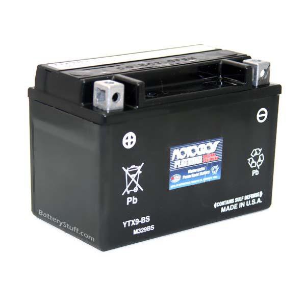

Originally Posted by kenny61 View Post
The battery on my L is going. Its really weak in sub 32F temps. Currently got a deka lead acid that only lasted 2 years. The bike is ridden often if not everyday never sits unstarted for more than a week. Question is which replacement should I go with. A better brand leadacid, gel cell, Lithium Ion?
I dont want to do the relocation just want a battery that last more than 2 seasons. I got a Yuasa in my quad which i start 4 times a year and its been in there for three years with no problem
If you are running heated gear, or a lot of other accesories, you should stick with a lead-acid battery. Motocross manufactures batteries for Yuasu. I bought a Motocross battery for my 200cc trail bike, and it has performed flawlessly. Therefore, I encourage you to check out the Motocross YTX9-BS battery, which costs $65.
http://www.batterystuff.com/batterie...motocross.html
