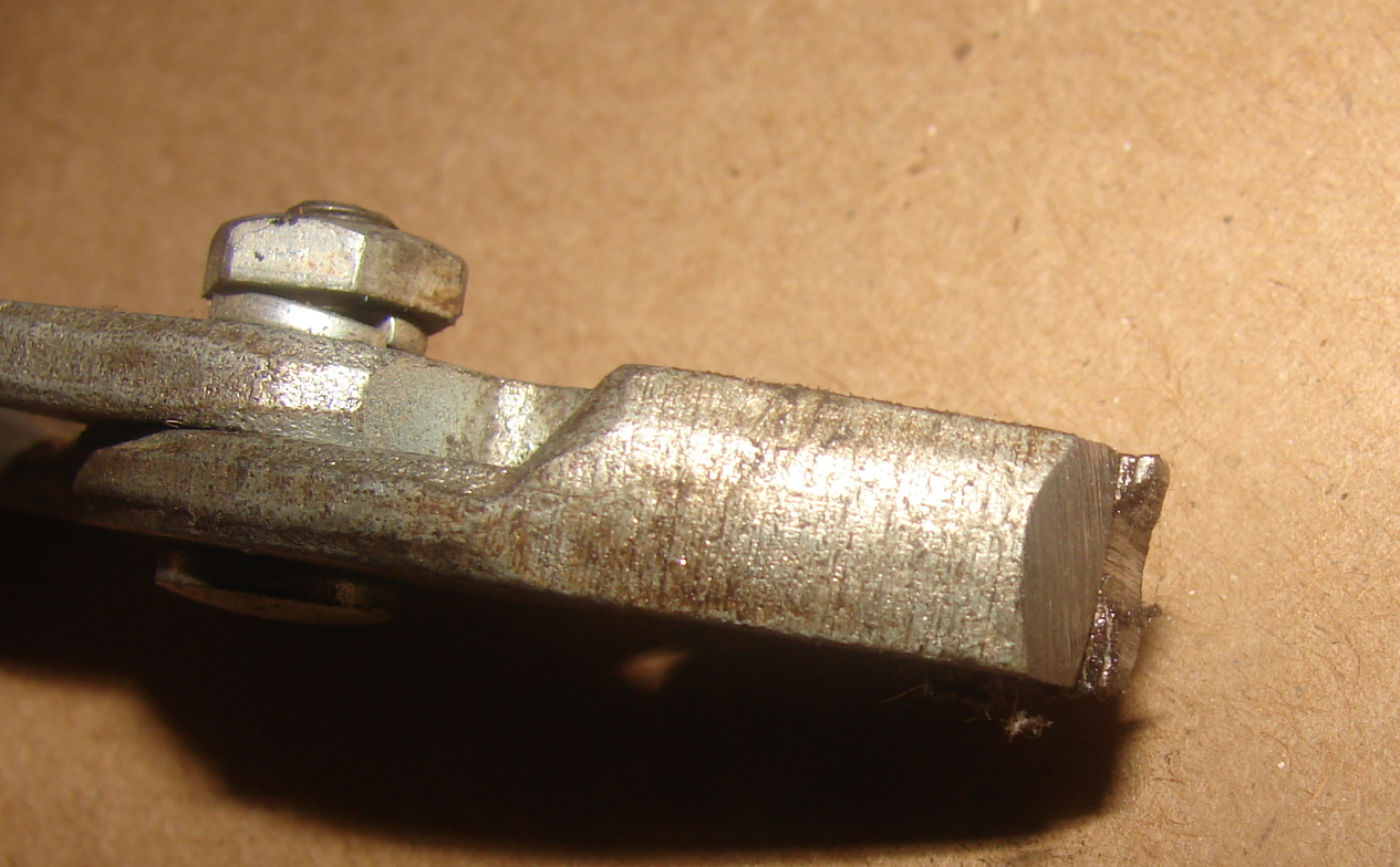

Originally Posted by stainlesscycle View Post
10 second master link pliers - cost $0.00
Explain their purpose.
installing and removing master link clips. i have modified them a little more so the one unground side is now shorter than the other. instant on/off for master link clips. i now have 45 seconds into their construction. not pretty but very effective.
Gotcha. Never had any trouble just poppin’ ‘em off & on with a screwdriver.
no chance of bending, losing or damaging them with the pliers. i could pound nails with a socket wrench, but i use a hammer (most of time).
i can barbarian with the best of them, but the right tool for the job makes life a little easier - and i do a few chains a month...
