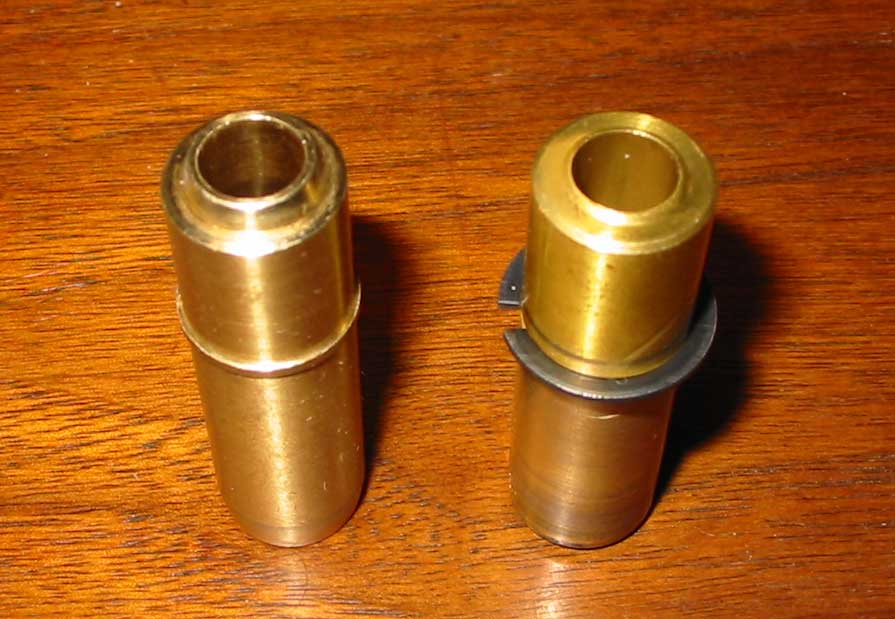

Does Anyone Have A Close Up Picture Of The Top End Of A Later Model R100 Airhead Valve Guide. Do They Have A Champhered Step On The End? Apparently This Helps Scrape Oil Off. My Guides Have Been Replaced And The Guide To Valve Clearance Is Correct At 2 1/2 Thou But After Running There Is A Puddle Of Oil In The Inlet Under The Guide. The Engine Chews Oil And Has Carboned Up The Piston And Head Badly Causing Detonation. I Have De- Carboned Them And Removed The Engine Breathers From The Inlets. This Curred The Detonation But Not The Oil Consumption And The Cylinders Are Already Caboning Up After Only 1000km. The Bike Is A 92 R80 With A Sibenrock 1000kit Fitted. I Had The Pistons Measured Today And The Ring End Gaps Are Excessive But This Doesnt Explain The Oil In The Inlets.
Any Ideas ?
They do have a scraper lip on them, but depending on how they were installed this could have been damaged. I've seen them hammered flat.
Intakes don't wear that much, though. Exhausts wear out pretty quickly on the later Airheads.
Left is an aftermarket guide, right is an OEM guide. Both have scraper lips; the BMW lip is shorter but sharper at the top. Both work well.
