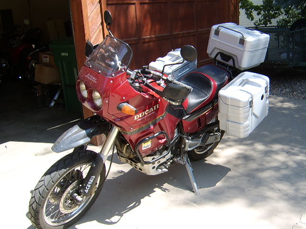

Old 07-16-2008, 11:12 AM   #1424
Durangoman
Yeah its me!
Durangoman's Avatar
Joined: Feb 2006
Location: Durango
Oddometer: 758
Got the H&B crash guards and luggage installed. New Corbin and Anakees
BMW R1200C
Triumph Bonneville T-100
Honda GB500 --- For Sale?
2001 Kawasaki W650
CT110 !?!?!?
Durangoman is offline   Reply With Quote
Old 07-16-2008, 11:14 AM   #1425
christian
Exchange your GPS Track!
christian's Avatar
Joined: Jul 2004
Location: Redwood City, CA
Oddometer: 2,535
can you take a close up picture of the lower end of the forks where these Acerbis fork guard are installed ?
thanks
Yamaha Majesty '08
KTM 690 Enduro '10
KTM 640 Enduro For sale
christian is offline   Reply With Quote
