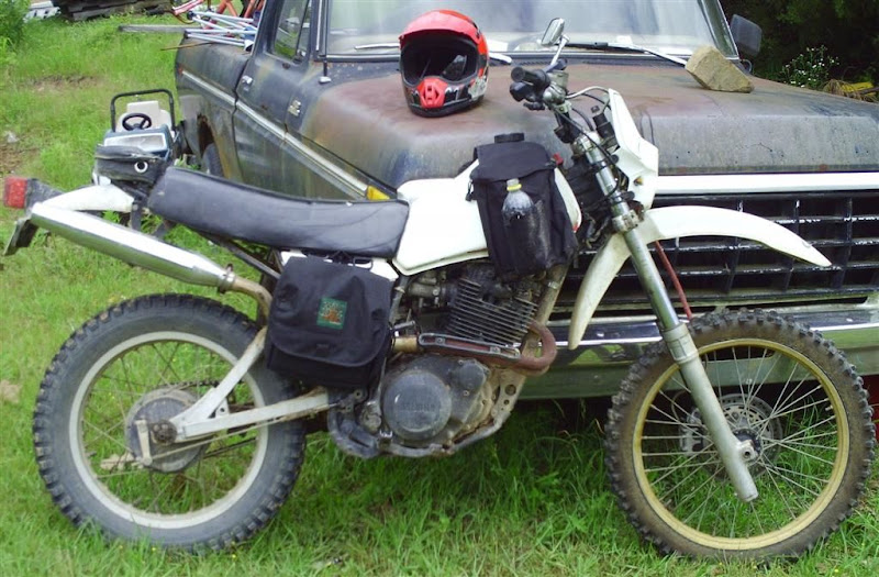

So its not a 600,
Before:
After:

Originally Posted by Zecatfish
So its not a 600,
Before:
After:
So, Hows the stopping now??
I'm not impressed to say the least.
Not sure whats going on there. Maybe the pad material? It honestly doesn't feel different from the old drum. If you get on them hard and pads start to warm up it seems better.
One last note the wear pattern on the rotor is not right. Like its only grabbing the inside 2/3's of the rotor.
Over all the ride is Lots better on the local dirt roads.
Do you have all of the air out of the brake line? Is the disc bend? My friend has a xr 600 and can stand it right on the front wheel!!
The forks have to be worlds better the XT forks!
