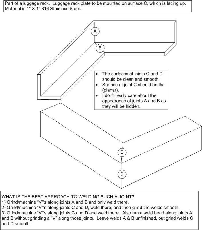

Originally Posted by WIsixfitty
assuming a .125" wall thickness I agree with gsweave on amperage. Just don't camp out in one area too long.
I dunno but using a 316 rod seems like a reasonable idea too. I do not know anything about what rod gsweave recommended. 308L will also work just fine.
In terms of host material I guess if ya got 316 laying around, use it, but 304 is a much nicer/cost effective altrenative.
I would also chamfer or bevel B and C if you will be grinding weld smooth.
Just fuse (no filler) D.
Put a nice weave/fillet in A.
Once welded, take a dead blow hammer to true up. Stanley's steel like to move alot.

Originally Posted by bosco
I am curious why you would miter the corners rather than cope them? Isn't a coping a stronger joint?
How do you cope angle "iron"? Notch out one horizontal flat and the other vertical flat?
I only cope when using a round or enclosed tube when it has to join up other than a butt joint.
Miter seems the easiest with imo more than enough strength for the application.
I tried to find an image w/out luck. Basically you leave one piece intact and cut the other to fit so that coner to corner weld includes both the corner and the flange. (okay some my discription sucks, too ). Anyway, you're probabley right in that a miter is strong enough and certainly easier.
We normally cope the corners. But we are building for ease and speed, strength. Notch one flat, butt other two flanges.
Mitered is prettier
