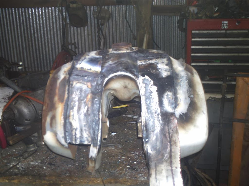

I wanted to say thank you for the ADVice you all gave me on welding sheet metal. The torch size etc.
I took my old XT gas tank and cut it up today to make it wider and a little taller for increased capacity. How much? I 'm adding 6" to the width and 2" to the height. I'm guessing that it is going to be around 2 1/2 gallons as a rough estimate. For a total of about 6 gallons without adversely affecting anything.
I'm gas welding the sheet metal with 1/16" rod and a 0 sized tip. It's fairly easy is working nicely. I'm cutting up an old Nissan hood for the sheet metal to work with.
Thanks again, it may not be pretty but it should be functional.

Originally Posted by artk
pics please
Ummm, NO,
Its not pretty but its coming together, I just started on it today. Might end up looking like Frankenstiens Monster.
Rat bike looking creation at the least. Using the sawzall to cut sheet metal. I love that thing.
I'm still making holes if I'm not careful but they're easier to fill back in with a gas rig, and you work slow with very low heat you can see the metal start to almost boil and work the metal where you need it. A lot easier than my stick welder. I've never been able to weld sheet metal with it.

Pictures... The MAD MAX tank Conversion.
From XT-Morph
I'll post the rest someplace relevant, or follow the link and browse them there.
