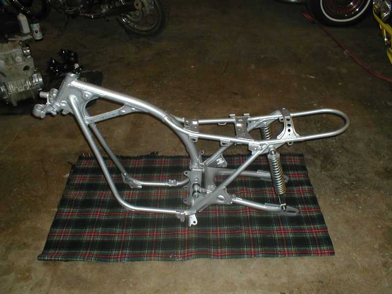

It's freakin' cold!
I'm not getting a whole lot done lately - the heat in the shop is worthless when it's 15F outside. I did manage to get the frame painted, and the swingarm and head bearings put together.

Old 01-18-2008, 07:31 AM   #70
pnhd65
renaissance man
Joined: Oct 2007
Location: central pa
Oddometer: 301
Frame looks great, keep up the good work.
