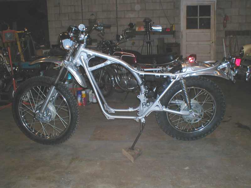

It's been warmer lately (the 30s!), so I've actually been getting a lot done. I spent some time degunkifying the engine, so now it's ready for me to replace all the seals. I also retorqued the head.
I cleaned 35 years of chain goo out of the sidecover, only to add new goo in the clutch cam. I'm trying not to get too carried away cleaning (it's going to get dirty again, I promise), but OCD takes over sometimes.
This is a lousy picture, but it's starting to look like a bike again. I spent 2 hours over the weekend putting the taillight on, since that necessitated starting on the wiring.

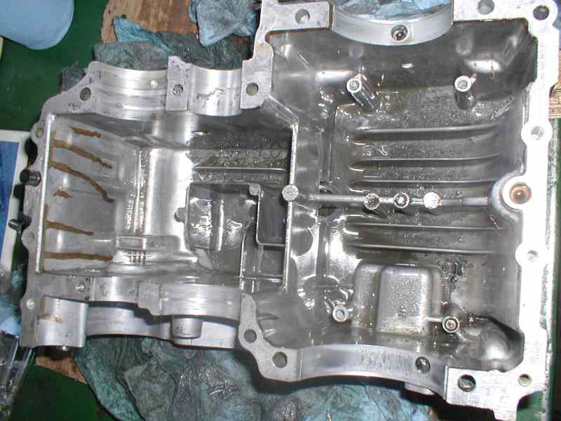

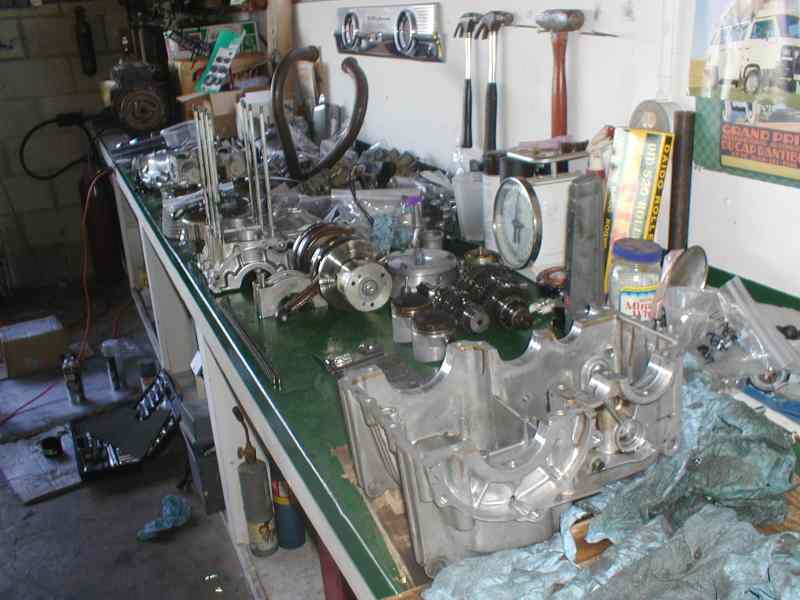

I got some shop time last night, and finished splitting the case halves - check out the sump:
I think it's a good thing I decided to clean it out. Not a lot of evidence of routine oil changes either.... I suppose this is progress:

every step further away is really one step closer to the end.
Good job, love the pics.
Sympathize
Oh, yeah, any idea what the slurry is from? anything in particular coming apart> or just neglect?
